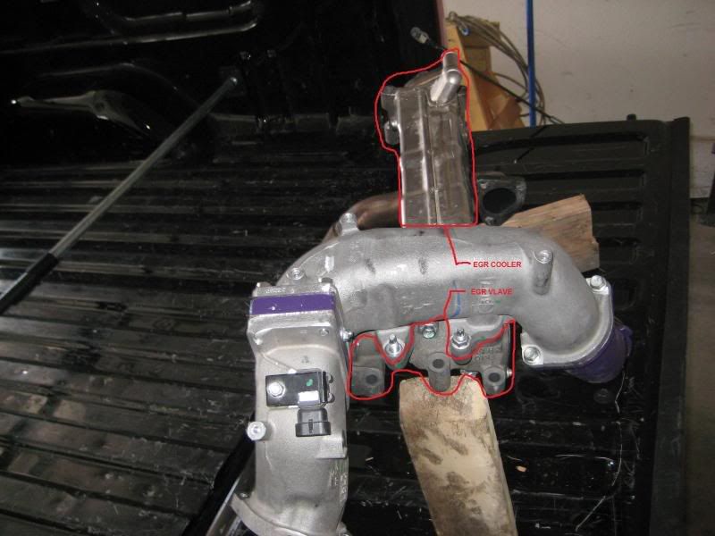

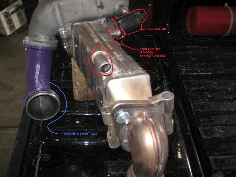

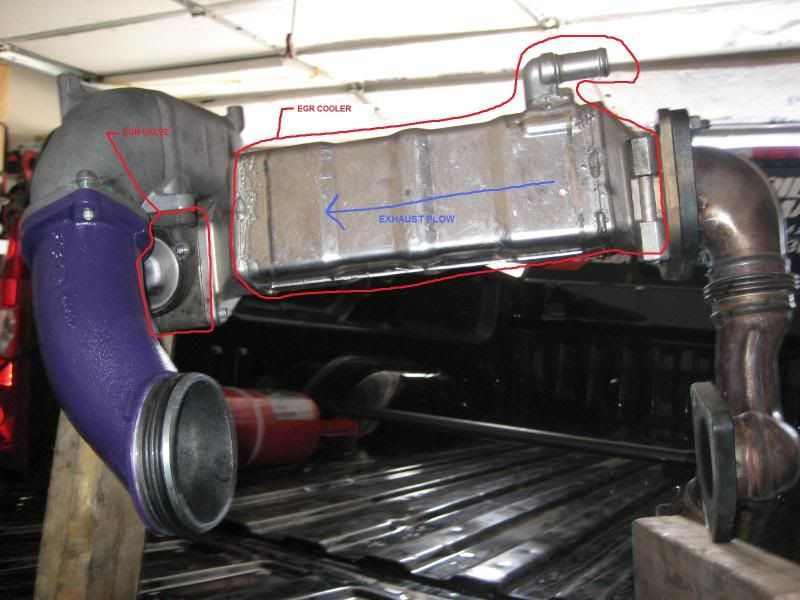

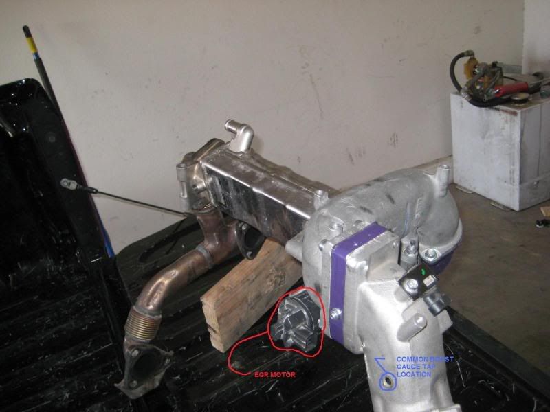

Pics of EGR (for reference) LMM
Hope this can help some when installing a blocker plate, full removal, or reference when working on EGR/Intake.
EDIT: LBZ in not the same. This is an LMM EGR
