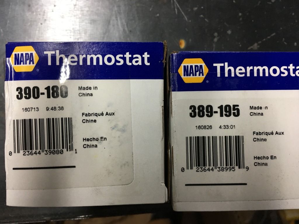

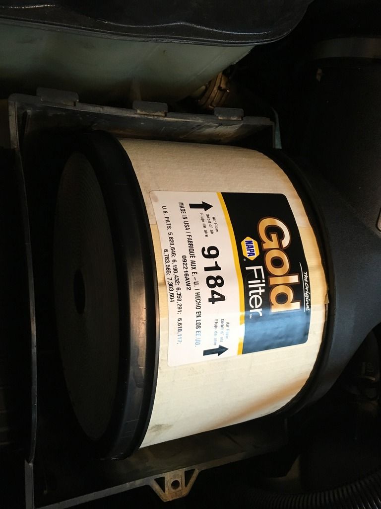

Ran down to the local Riebes (Napa) on my lunch break today to get thermostats (more on that later) and picked up a air filter while I was there...

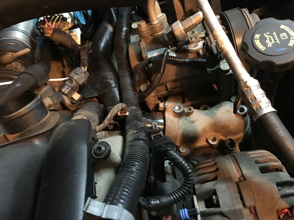

So onto coolant/thermostats. Whenever I get a vehicle I try and go through it and flush everything, so I have a baseline on it, and have quality fluids in it. That being said, I noticed on my 800 mile drive home the temp gauge was moving around a lot. From the readings on the guage, it was bouncing between 180 and 205. Well since I picked up the Insight yesterday, I plugged it in to see what the temps were (assuming the temp gauge was as inaccurate as the one on the LB7). So on the way to work this morning truck hit about 170 when I hopped on the highway, but then dropped down to 155-165 and never really warmed up. Ambient air temp was around 25-30 degrees. After seeing the temp drop, figured i had bad therms and since I wanted to flush the coolant might as well replace them.
Didnt take any pics when I had it apart, but here the pic on re-assembly...
So, after looking around for a few minutes for the drain, I hopped online and read a few things that the LMM doesnt have one. Doh! Pulled the clip on the lower rad hose and drained the coolant the messy way. Once it was buttoned back up, warmed her up, burped it, and went for a test drive. Warmed right up and stayed at temp! Did notice that when the truck is at operating temp (180-185 according to the Edge Insight) the temp gauge on the dash was reading just under 210, so good to know where the needle should be at least... Be curious to see if I get a little better MPG with the motor running at temp instead of 160ish...

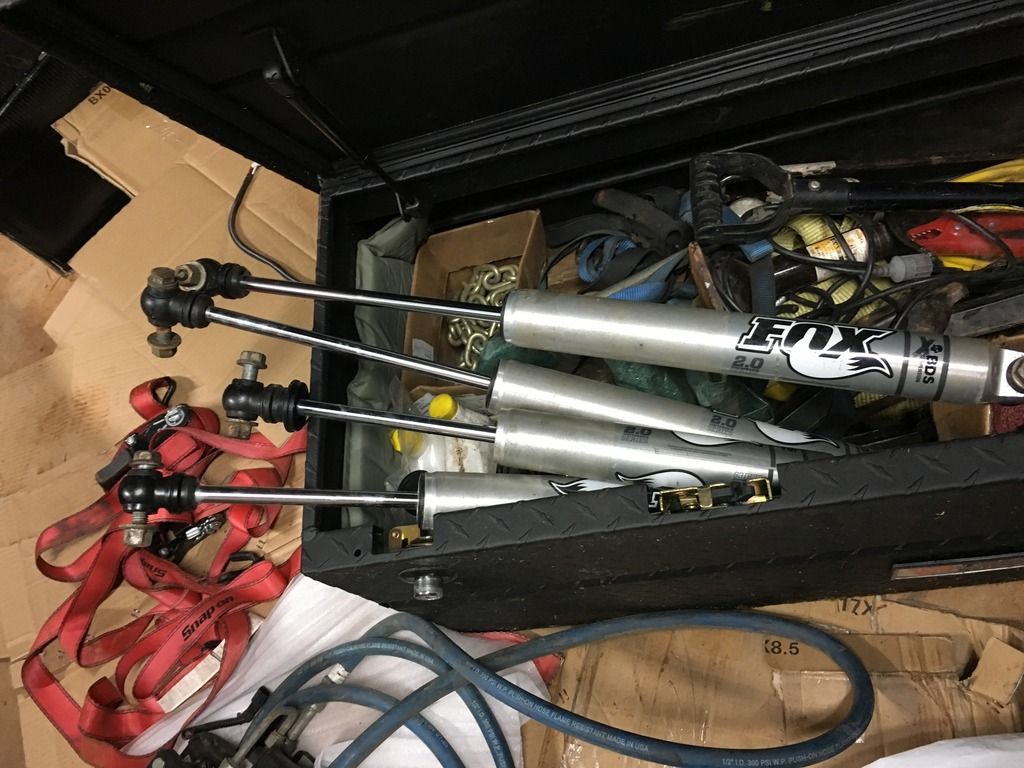

What lift did you end up going with? I will hopefully be lifting mine this year too and was thinking of having the D MAX store do it. Did they give you a deal? I keep hearing mixed reviews on those guys.
Cognito 4-6", standard torsion bar drop. Reason I went with that instead of the NTBD is because its cheaper, and because I had the Fox shocks off of my old trucks that had a 4.5" BDS lift, and the front shocks wouldn't work with the NTBD lift. That being said in a year or 2, if I need the additional ground clearance, and/or when its time to replace the shocks, you can get the NTBD conversion for $500 and convert the standard lift.
