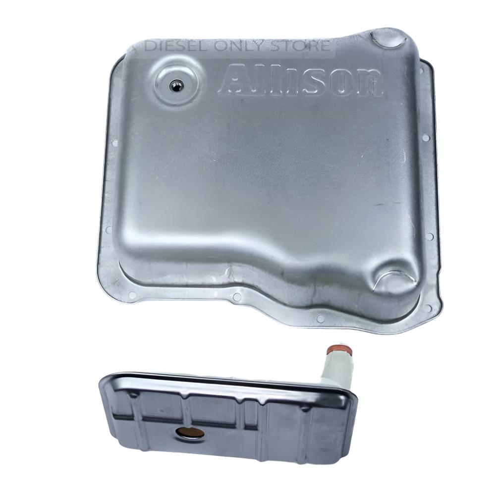

If Woody wants to do some good, he should swap out the shallow pan, and the deep stamped steel pan while he's in there.
1. Drain the OEM pan, swap the external filter (dont lose the magnet) refill.
2. Drive around the block a few times. 15 minutes or so.
3. Drain, swap to the deeper pan and deep style filter.
4. Refill again. Fill to the "Cold Full" when trans is at full temp. Done.
