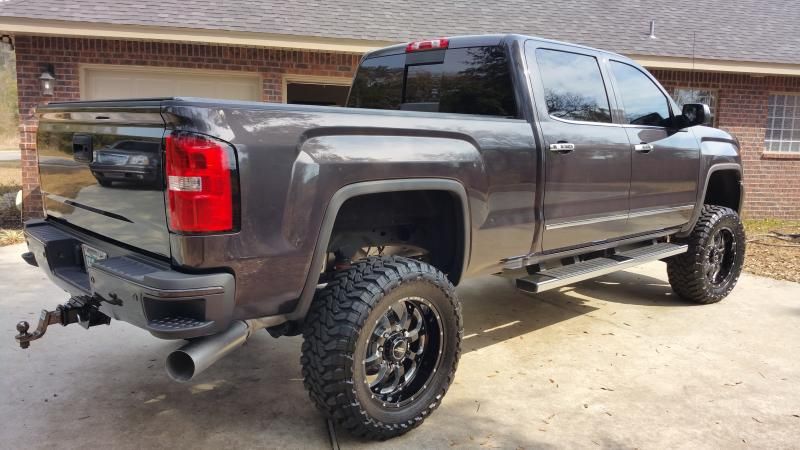

Finally got it cleaned up and got a few pics. Front is set 5.5 inches and back is 3 inch block. 35x12.5x20 Toyo MT on 20x9 BMF Novakanes. Angles are stock and truck rides better than stock with less tire pressure and Fox 2.0's all around. Added the BDS 9500 steering stabilizer, MA sleeves, and Cognito braces. Truck sits 47 to the fender in the front and 47.5 in the back.

SWEEEEEEEEET truck!!

Looks awesome, I just did the same lift on my 15. Went with 37's. Gotta figure out this slight rubbing issue though lol

Looks good. I'd demold the chrome strip too along with what you've already done

Great looking truck man....definitely clean looking!

Looks awesome!!

As I've seen before, looks great. Needs some Auburn love though!

Awesome looking truck! I am debating the cognito 4 inch and the bds 4.5 right now. I think I'm going to go with the bds. I want it to ride close to stock if possible.

I'm real happy with how mine rides. I was looking at Cognito and didn't like that it widens the front track. Makes it tougher to clear a wheel with offset.

My truck rides just like stock. I have a slight rubbing issue because I went with 37/13.5. I'll get that resolved, but BDS is definitely the way to go.

No doubt cognito makes great stuff. They just need to realize the fact that they increase the front track width is a MAJOR turnoff and a complete deal breaker for a lot of us.
