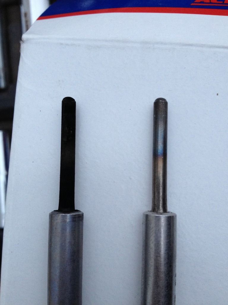

Last month my truck showed a continuous check engine light with the underlying code found to be PO677 (a failed glow plug on the number 7 cylinder). More importantly, the local Chevy dealership found that the bad glow plug was also seized into the aluminum head. I had them check the other seven plugs (there is one per cylinder) and the same plug on the opposite side (number 8 cylinder) was also seized in place.
For those who have never seen one, a glow plug is a 5 1/2" long, hollow, galvanized steel tube the same diameter as a Number 2 lead pencil. There is an electrode running through the center of the hollow tube, and the exterior of the tube has approx 1/2 " of threads located at its midpoint which screw into the aluminum heads. The nut to remove it is approximately 1" up the tube from where it enters the head, so torque to remove it is in this unsupported area of the hollow tube. One per cylinder, a glow plug is a little heating probe which assists in igniting the fuel in cold weather. Like a spark plug, they do not last forever, and are designed to be easily accessible and replaceable. The Chevy tech told me that no anti-seize is used by the factory during initial assembly of the engine. A truck will likely start with a bad glow plug, but the continuous check engine light will make it impossible to tell if any other systems are failing.
Per the dealership, three Chevy techs with a combined 75 years of experience used all their knowledge and techniques (including heat and extended soaking with penetrating oils) to free the stuck bad glow plug, yet (as they warned was possible) the tube still broke in two. The electrode pulled out of the hollow tube while still attached to a portion with the nut, but part of the hollow tube was still in the head.
They worked for three hours on the other seized plug, and it finally came free. The other six plugs were removed without any major issues, but the thin galvanization on several was rusty in patches, and one showed a whitish residue similar to aluminum oxidation on the threaded area. To remove a seized and broken glow plug the entire head must come off of the engine and taken to a machine shop. Per the dealership, the quickest method to remove the head involves lifting the entire cab and front end off the frame and into the air in order to have access to the complete engine, and this is what they did with my truck.
A total of 30 hours of shop labor was required (not counting the machine shop work). If the seized plug on the other side of the engine had also broken off, it would have meant also removing that head and an additional eight hours of labor (and hundreds of dollars more in parts such as gaskets which are part of head removal and replacement).
The primary Chevy tech on the job commented on how clean my truck was, and that no signs of abuse or other problems were present. I had all eight glow plugs replaced (and the tech did use anti-seize on the threads) in order to prevent a re-occurrence of this problem. Total repair bill, including the $125 machine shop fee and the extra seven glow plugs, was $4,500. After my own research and talking to the tech, it was my decision to replace all the glow plugs at the same time because it is not uncommon for them to go out within as early as 100,000 miles (I saved those which were still functioning for spares).

A few pics of my truck and of a glow plug:
