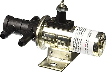

Now I am reading where if you use a 12 V solenoid fuel valve that when the power off is normally closed and with power on it’s open, the valve heats up fairly quickly. You can’t just drive for hundreds of miles leaving the power to the solenoid till the valve is open, it just overheats. So unless I can find one that doesn’t get hot that’s not a possibility either.
Mine works fine - it is not on for hundreds of miles though. These valves were used on vehicles with dual tanks to switch the tank that feeds the engine - pretty sure they do have them on for hundreds of miles

I don’t know what kind of solenoid valves the truck world uses, but if you want something that will do 100% duty cycle with no problem, get one meant for industrial use. I’ve seen Asco and Skinner solenoid valves run energized in chemical plants for months at a time. They aren’t cheap but you won’t have to worry about leaving it powered open for a few hours straight.
