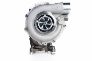

As far as I know the turbo is a stock Garret. I need to replace it before it grenades in a place I don't really need it to grenade. There are soooo many ways to go. I tow trailers here and there, have to drive thru the mountains in Idaho as well, some times pulling a trailer, 2000lbs to 7000lbs.
what would be good drop in turbo. not to interested in a rebuild for obvious reasons....
I know you don't want to rebuild but due to your towing environment you might want to consider a BatMoWheel. Faster spool up, better pressure curve at the bottom end, and lower EGTs. Here is a link. I'm in a smog state so "stock-looking" is important. It might be important to you too if DSP gave the guberment your address. ;)

If a rebuild will work I would go that route but seeing how it's been on the truck for so long I don't know if something else may wear out on it. I'm not to knowledgeable about turbos and what I would need for a rebuild, I would go that route knowing it would work fine and save some mulah$$...

A rebuild is not as simple as R&R the compressor. With that many miles on it the complete vane system, turbine, and bearings should be replaced. IOW, buy a quality rebuild and then substitute the compressor with the BatMoWheel. It will look totally stock. Otherwise it's an aftermarket, or Garrett upgrade.

I have the Spoologic wheel and rebuild kit. The stock turbo appeared to work just fine with my desires for towing, city and highway cruising. I have to thank you for turning me on to this. Makes it a lot easier than spending hours hunting for it.

It doesn’t seem like you’re trying to make a lot of power or anything, so depending on what you’re wanting to spend, a cheetah would be my choice. But anything comparable will do nicely. A stock replacement is also an option if it’s affordable and available

it has over 200,000 miles on it, I think it's time for a rebuild. I really don't want to spend a ton of dough if I don't need to. I have a spoologic rebuild kit and comp wheel. I don't use it daily but when I do it's for towing, around town and the highway usually for picking up stuff. I'm not looking for major HP. Also looking into getting a Edge CTS3. I have the hand held when I got the EFI Live several years ago buit would like to upgrade...

. . . .I tow trailers here and there, have to drive thru the mountains in Idaho as well, some times pulling a trailer, 2000lbs to 7000lbs.
"if it ain't broke, don't fix it" . . . makes sense sometimes but is dependant on your environment. When I'm taking off on a 15hr. flight over water to NZ I'm kinda glad the FAA replacement policy is based on hours of service regardless how pristeen a part appears. Driving the kids to school or navigating 10-15 miles from home, who cares! What is the cost and inconvenience of a failure? But look what you wrote and ask the same question in the mountains of Idaho. It's an insurance policy and its a useless cost . . . until you need it! Millions of homes in Calif don't have earthquake insurance . . . until its paid for!! LOL. Your truck has a 1/4 million miles on it and "may" go another 250k. What is "peace of mind" worth . . . it differs for everyone.
The thread started as looking for improvement in the towing situation. There are better than stock alternatives but all require either complete turbo replacement or R&R of the compressor. If you are going to the pain and suffering of replacing the compressor it's rather foolish to not clean up the turbine and replace a bearing. YMMV
#24 ·
I have the rebuild kit minus the turbin, I won't be driving it for a while. After giving it some thought I think I'm going to go on the safe side and pull it this way I can take a good look at what else is going on behind there, perhaps replace the stock Y bridge while I'm at it..
