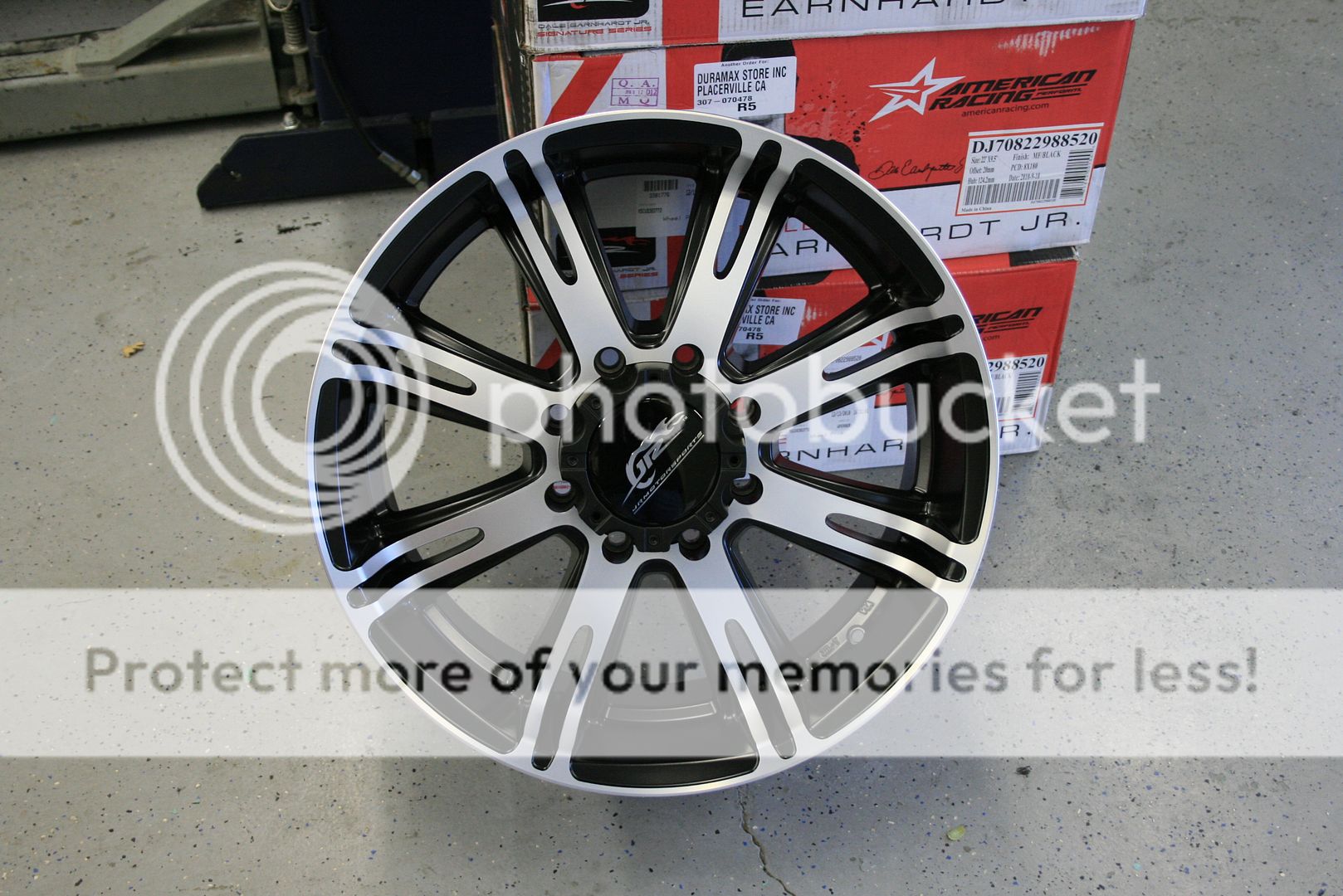

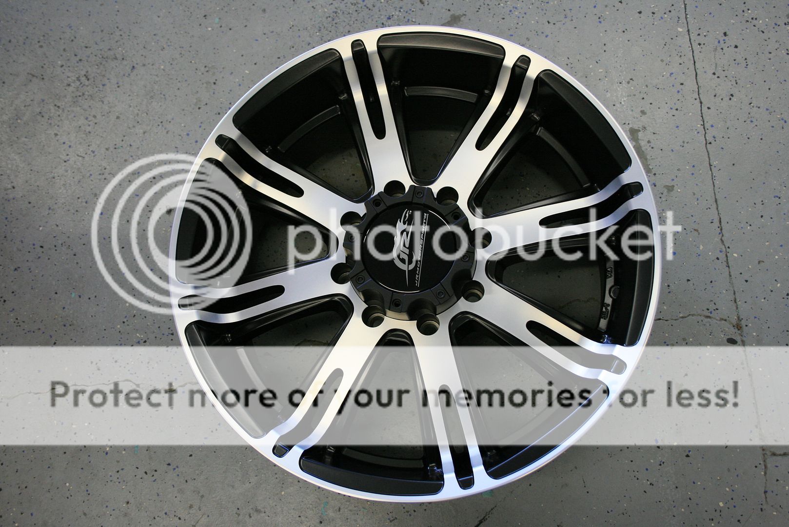

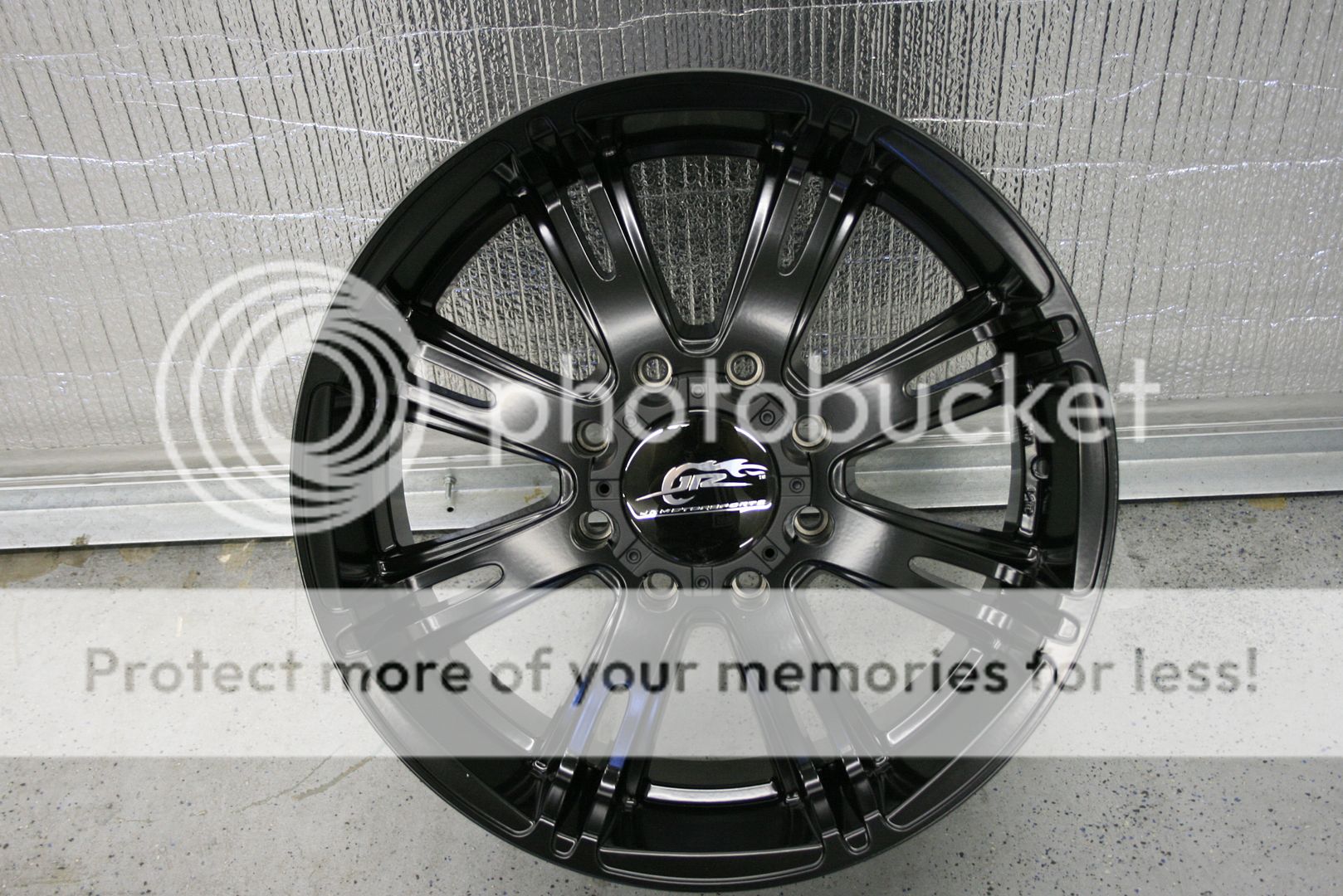

So with very limited wheel sizes available for the new 8x180 lug pattern we are trying out these Ernhart JR #DJ708B. These are going to Powdercoat tomorrow. They will be all semigloss Black before going on the truck. Sizing will be experimental for a lifted truck 22x9.5 with +20mm offset. Most wheels for lifted trucks are negatively offset to gain clearance so they stick out. These should work with this project and stay in the fender well.

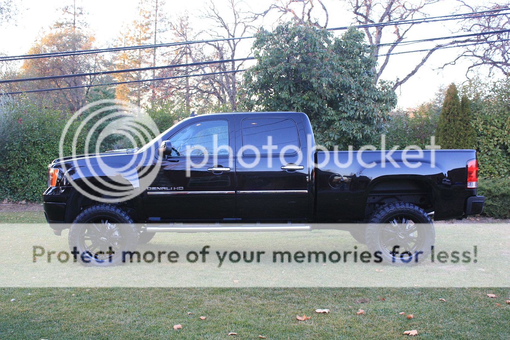

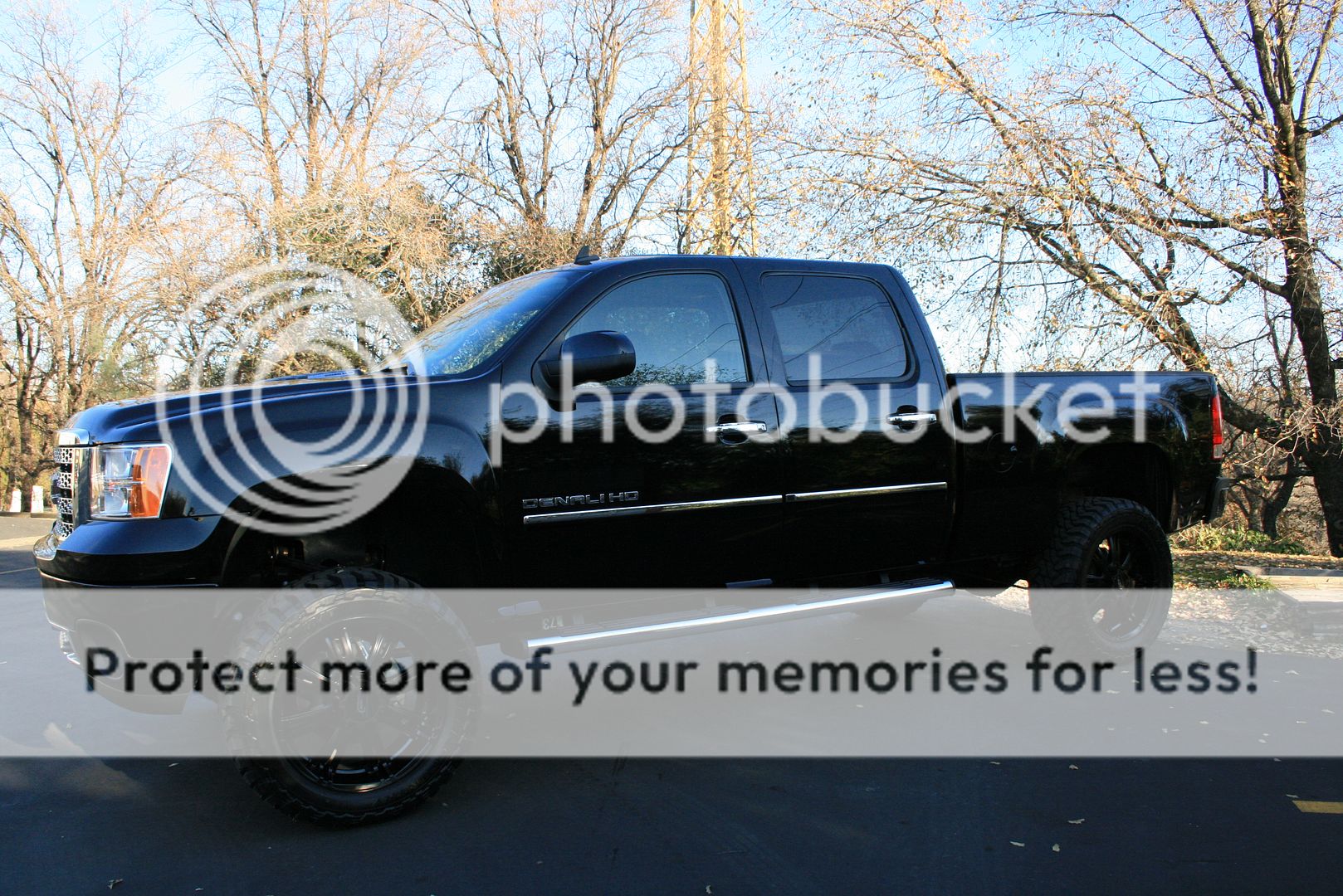

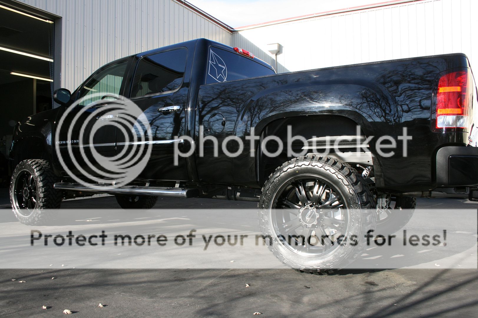

Here they are on the truck, wrapped in the 35/12.5/22 Toyo MT's.
The +20mm positive offset wheels worked out sweet. The tires are where they should be.
Here is a shot of the truck on the ground. The lighting sucks but we will get some more up soon.
