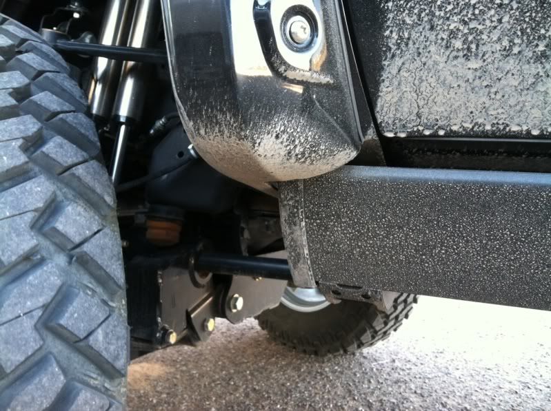

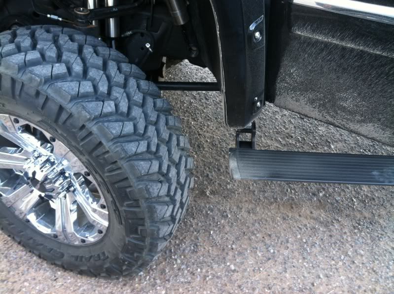

i had to trim the flares with my steps, did it very discretely and doesn't look back, but steps still protrude out a bit and don't really tuck away like i originally thought
#133 ·
You would think the amp logic would think this stuff through to work with all the different aftermarket parts. It really sucks that you cant use the fender flares with the steps. My paint from the trim down is getting hammered. Im going to be putting rino liner or some equivilant product with UV protection . They garntee color match.

How did you get the fender flars to work with the steps ? Also how did you get 37's to fit ?
#150 ·
Sorry, I was asking the guy with 37's but looked back and I answered my own question.
