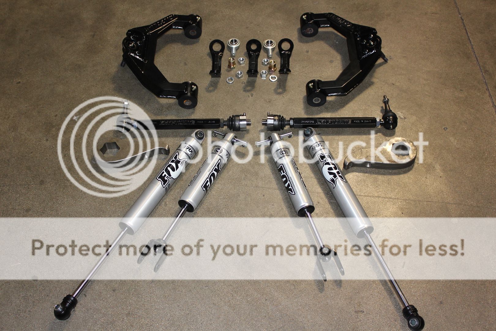

OK the new truck is here and we are ready to start the upgrades. Here is what we are starting with.
2011 GMC Denali LML (Onyx Black)
Here is a list of the first part of the build.
Lift- Cogntio 4-6 inch NTB with New Fox shocks
Tires - 35/12.5/22 Toyo MT's
Wheels - 22x9.5 Dale JR. (Powder coated black)
Amp power running boards
Gears - 4:10 G2
Much more to come as more performance upgrades hit the market.

You will use your factory torsion keys. Torsion bolt adjustment will always determine your final ride height just like factory. No need to max out the adjustments.

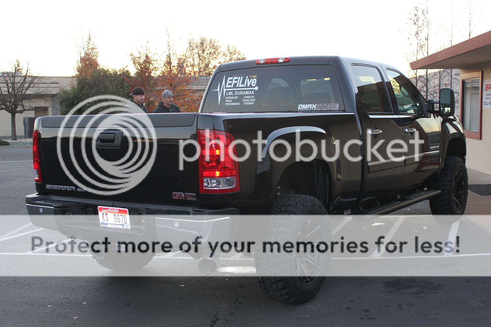

After years of avoidance EFI-LIVE is now supporting the LML. Idaho Rob plowed his way through a west coast snow storm on Monday night and dropped us of a sample of what he has been working on. Although the tuning is not quite ready for the retail market we are thoroughly impressed. Nothing else compares.
While Rob was making some tweaks on our LML, Dmaxstore added some style to his. With our new leveling kit with Fox shocks and some sweet 18" wheels and tires.
