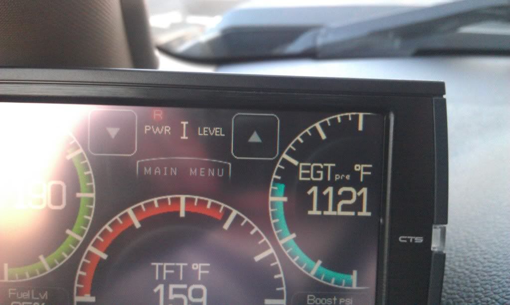

So I'm driving to go play hockey and I noticed my edge insight cts is showing my egt's starting to rise like crazy. It was at about 680 and then went to 1100 and stayed there for over ten min, which is when I got to the rink. I was driving for about 40 min before that. I'm wondering if it was the truck cleaning the dpf?
Truck is stock engine wise, just running insight with the option to use pre dpf egt monitor from the truck itself, prob is not installed yet. It also showed a red r above the power letters on the screen. See pic below

In the owner's manual it states that the red "R" signifies that regeneration is in progress.

x2, looks like a regen to me.

Ok thanks, I didn't have my manual on me, but that's what I figured also, just wanted to check.
