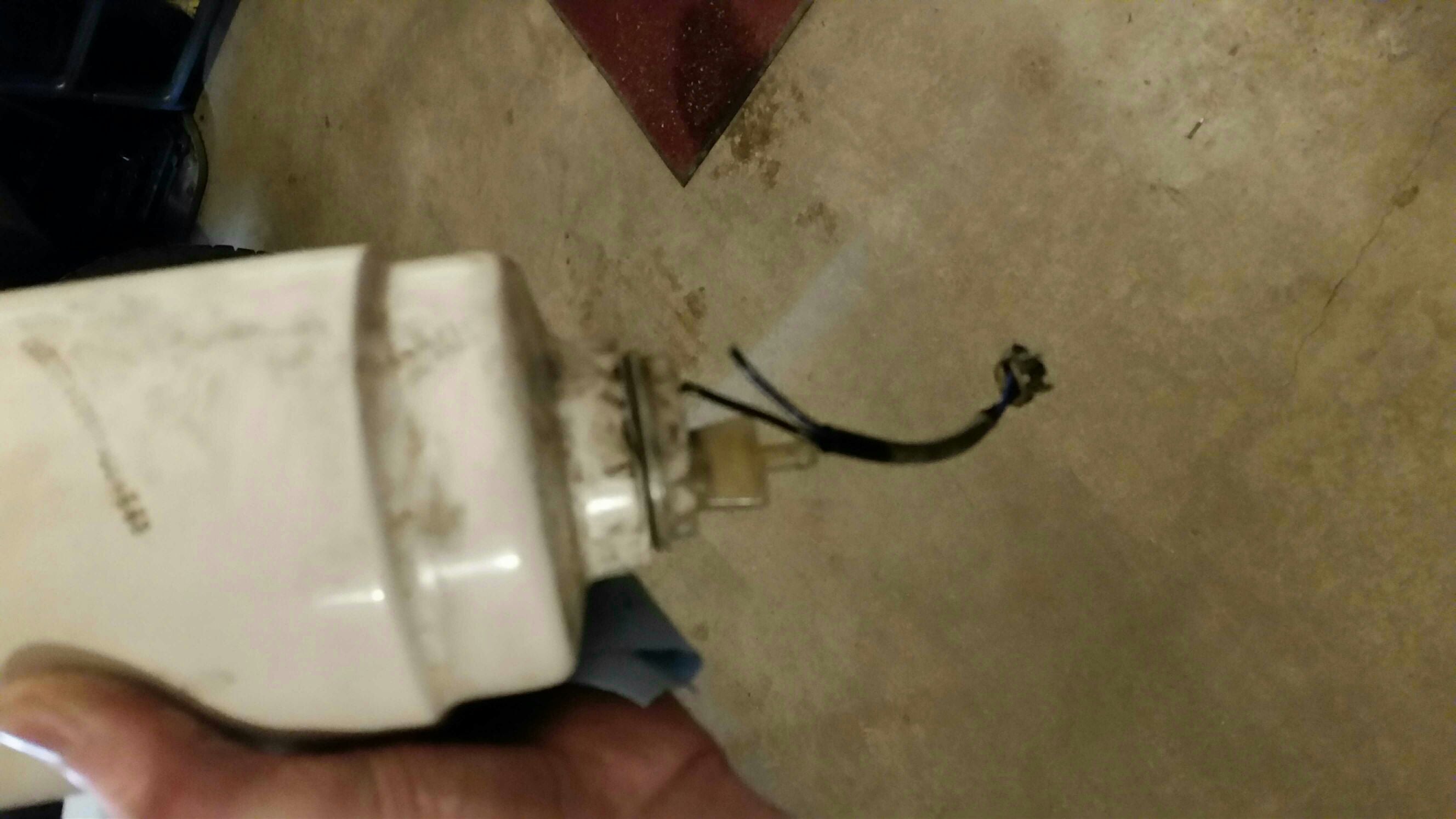

I checked the top off the tank dry as a bone and followed the lines and didnt see any hint of diesel. Im about to take the fuel filter off but i already took the bleeder off and pumped it and nothing come out and the pressure did not build (it didnt get harder to pump)

That is the Water In Fuel Sensor [WIF] they are junk and don't always work as designed-- NO, it will not cause a problem or set codes if the wire is broken, as long as it is not shorted. Many just delete it.
Do as I said-- PUT SOME FUEL IN THE TANK, then try to prime it.
