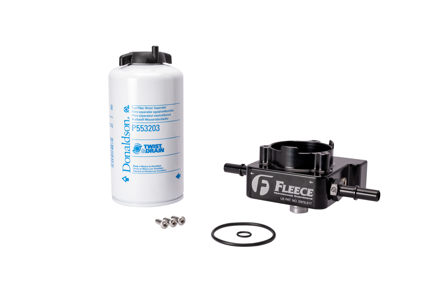

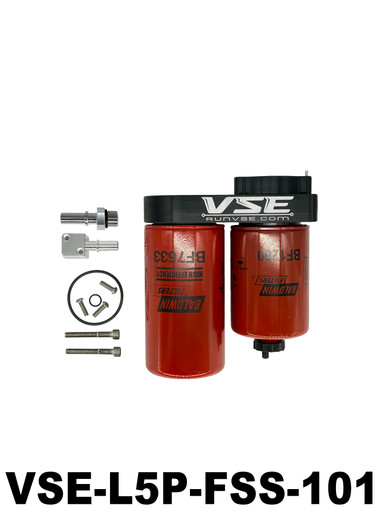

Few options out there I attached a few different ones. I am personally eyeing the 2 filter setup from VSE as I think it does a better job than the factory setup and keeps water separator sensor working like it should. Little pricy but it is superior IMO.
- just the billet bowl
- single filter replacing stock unit
-Dual filter replacement
