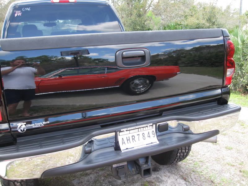

Nice paint job on the tail gate!!!

Thanks, My speedo is off 13%,I took total mileage X 13% added that to miles traveled / Gallons used.........think I did it right.......the tailgate is a reflection of a pic with me with the 69 in the background :gearjamin
