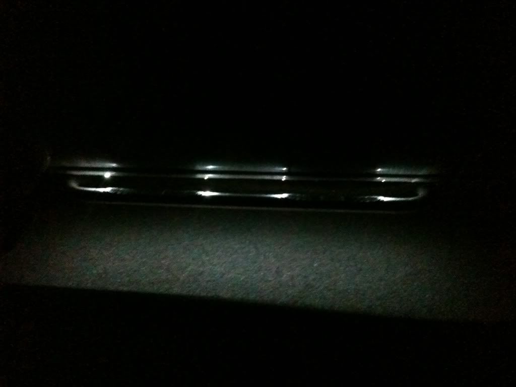

I thought I would do a lttle write up on how to install some LED lights on your AMP Steps or Nerf bars or whatever your using. I was going to buy the AMP Research led kit, but it would of cost mee $200 for the kit and a new module that is required for the lights to hook into. So I saved myself about $180 and I think it looks just as good if not better than the factory ones.
First off the supplies I used, but you can suppliment in whatever lights you want to use.
4 LD1 lights from superbright leds
10-15 Ft Wire I used speaker Wire
Connectors T-taps, butt, eyelet etc.
2 Self taping screws small size
Zip ties
I went with the LD1 lights because they are very small and you can mount them just about anywhere. I took some rubbing alcohol and cleaned the area that I wanted to hook the lights to and then used the supplied double sided tape to attatch them to the truck.
I attatched the Positive and the Negatives of both LEDs together so I only had to run one set of wires up through the plug under the footwell.
After zip tieing all the wires underneath I removed the 2 panels below to access the wires.
Once you remove the two panels it's easy to pull up the carpet a few inches to get the wires through the plug. I then took one of the eyelet connectors and a self tapping screw and grounded the LEDs to the cab of the truck behind panel #1 from the previous pic.

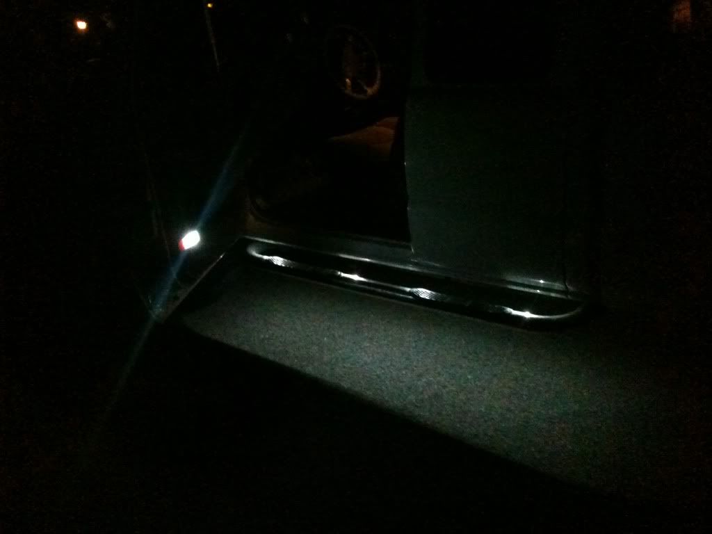

I just did mine i put 4 on each side. i love them i get so many comments on them also! sorry its not the best quality phone pic... ill try and get a better one!

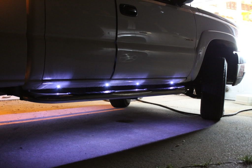

#24 ·
Here we go i found better pics. and i have had them on for a good 2 months with no problems. they are acctually holding up alot better than i thought they would. i was expecting to have to replace the tape like every month but they are perfect!
