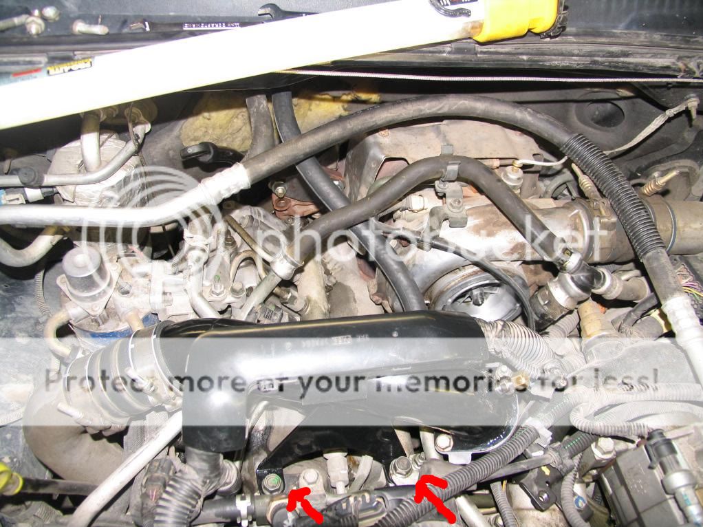

pull the black harness back a bit so you can work, be carefull with the harness. I didnt have the mp out yet in the pic.
remove these nuts and bolts(the ones with red arrows can be seen in the pic, the ones with blue arrows you cant really see here)

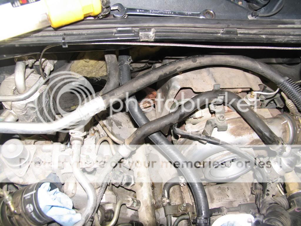

after the bolts are out, pull the harness on top towards the front of the truck and remove, then it should like something like this.

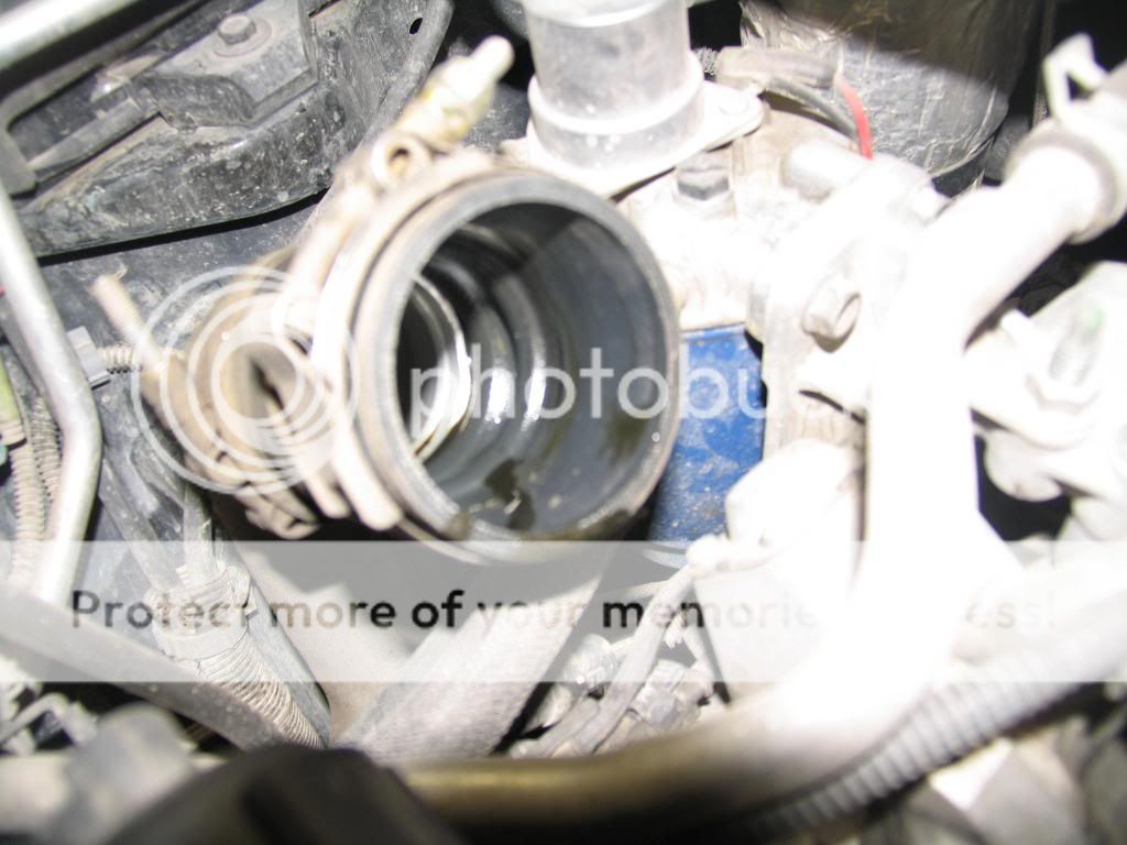

note the filthy rubber boot

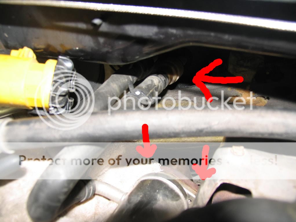

top arrow is the cooler hose you will be replacing, bottom two arrows show where to look for the bolt/nuts.

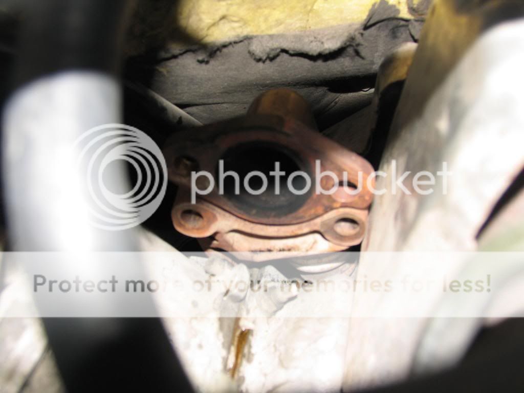

this pic shows where the heater hose will be going, and also what you will see one you wiggle the cooler out.

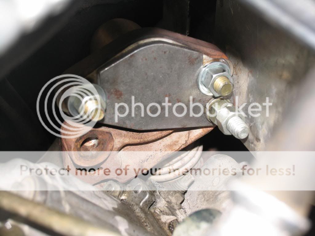

and this is where the cap is gonna go, you will want to get some bolts and nuts to get the cap locked down, i used some stuff i had layin around since the cap will just be temporary until i get my new up pipes. dont forget the gasket. i used two nuts on the bottom to keep from backing off(kinda ******* but its just temporary)
now slap the delete tube in there with the gasket and cinch er down, i had to cut the bolt on the left down, and the one on the right needs a space for the tab that holds the coolant line.
