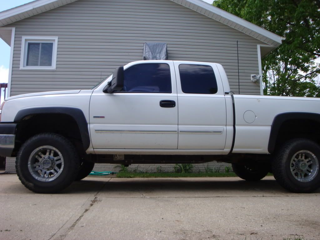

ok currently my truck is sitting with leveling keys an add a leaf on 285's my ride sucks. shud I remove add a leaf and find a one inch block or shud I drop it back down to stock and throw smaller tires on it. love the look but on the flop to keep it or lower it and keep wear an tear down an tire replacment low and get my ride quality back. what you guys think/what would you do? here is a picture
1,810 Posts
my keys are all the way down and the front is only a inch lower then the back

4,766 Posts
OK, Well fill me in on this.
Your bars are already all the way down??? If then your ride sholdn't be rough in the front.
YOu have a 1" block in the rear?? Remove that, then the front and rear should match and your ride should be a little better. I just can't see you havind a bad ride on t-bars that are not cranked. It has to be coming from the rear

no i have a add-a-leaf in the rear and I want to find a 1-2inch block whatever I need so that I can have better ride in the rear. right now it feels like I bounce all over and its driving me nuts just want it smoother, would takeing out the add-a-leaf and putting in a block help this issue?

I put 3" drop shackles on the rear and lowered t-bars all the way down with 285 tires and I love the look and rubs in one spot just enough to clean it with no rubbing noise and rides great...
Want your good ride back take those leveling keys out cuz they are a waste of money anyways and that'll help the front.... On the back I dont know how stiff those are so its up to you on those

Listen to this guy. Leveling keys r a quick way to problems. The add a leaf isn't helping. If u don't tow I would throw stock keys in like quick said and take the add a leaf and the overload out. New shocks and u r in business. U could run 285's with minor trimming.
