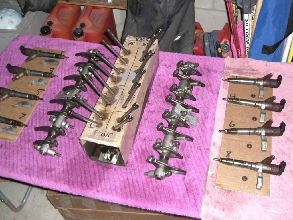

I labeled everything on how it came out, especially the push rods, injectors, rocker shafts and valve bridges.

Chevytothefloor has some good tips. And it is important to stay organized when doing this. As far as the push rods and injectors staying in the same order, it really don't matter. I have been building engines for 19 years and I did this at first. But honestly it don't matter. Just make sure everything is in spec. I.E. push rod run out. .008". That's when you take a feeler gauge and roll the push rod over it. So don't get your self all jacked up cause something got put out of order. I got manuals if you need them.

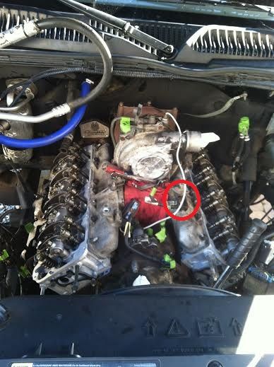

Well after working on it for a few hours each night after work, I removed everything needed to pull the heads except the manifolds. I read its better to unbolt the passenger side manifold from the head and let the drivers side attached but I cannot seem to get the bolts out on the where the manifold connects to the up pipe. Could I just double nut the studs to get them out of the head and leave the manifold? I bought a high flow manifold and need to install it. Is it easier to remove the drivers side manifold after the head is off?
Sent from AutoGuide.com Free App
#21 · (Edited)
Ok so I just got the heads off and I can't really tell where the gasket was blown but maybe that's because I don't know what I'm looking for. Anyway, what should I do to the block to prepare it for the new gasket and is there anything else that should be done before I install the heads? Also, the bottom of my overflow tank was covered in oil so I'm guessing that was due to the head gaskets?

Horrors of the EGR! This stuff is like tar and is on there so thick! I can't wait to see how much better my truck will be running with all this crap out of the intake.

#28 ·
Holy Popballs Batman! That looks gross! I guess mine is going to look like that when my heads come off. Good list of mod's to do. ARP head studs are a no brainer....
