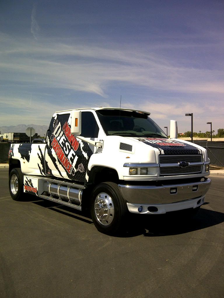

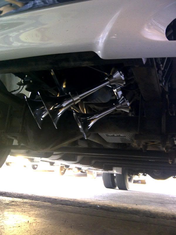

Heres mine. They are United Pacific 16" with 1/2" line, 1/2" valve, 3 gal tank and push lock fittings. They are pretty loud but could be louder. I have them pointed down (keep water and dirt out better) and out towards passenger side. Seams to work good. They are on a 06 Kodiak. Post up pics and info! I want to see your set up!
