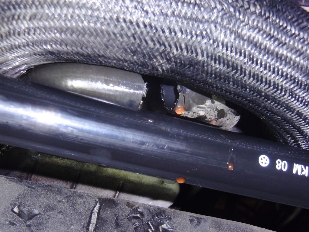

First thing to do is jack up your truck, and get some room to work with. Then pop off the front plastic skid plate to get access to the lower radiator hose area. Next, pop off the clamp that secures the smaller hose ,to the larger one.
I went into the kitchen and grabbed these big scissors we have, that cut just about anything... and in a quick...SNIP, I cut the small lower hose in two.
Obviously, you want to do this with the truck cold. You plug one side with your thumb, while the other side drains into the bucket. I only lost a tiny bit of coolant when I did the Snip. It was quick and easy.
This hose is at the very lowest point in the cooling system,which is another reason for doing it this way, and will drain the entire system. Its about 3.5 gallons.

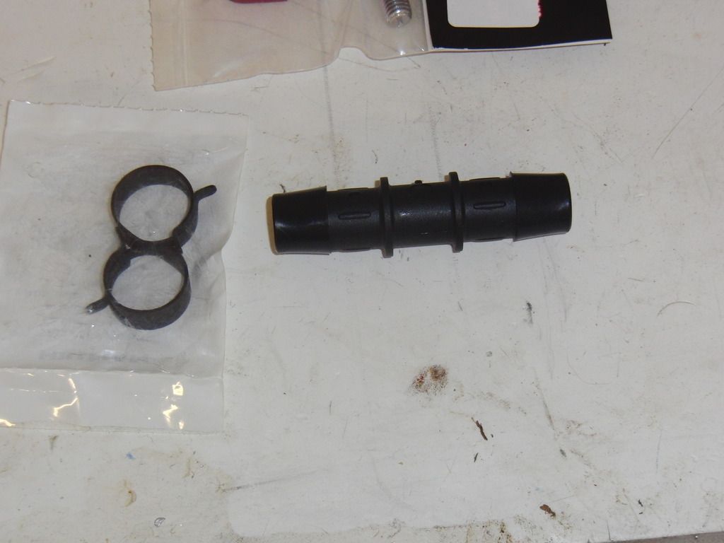

Next, you want to splice it back together. You will need a 5/8" splice, and two 1" spring clamps.
The splice fits a little loose, so the hose must be metric. If anyone makes a 17mm hose splice, this would fit perfect.

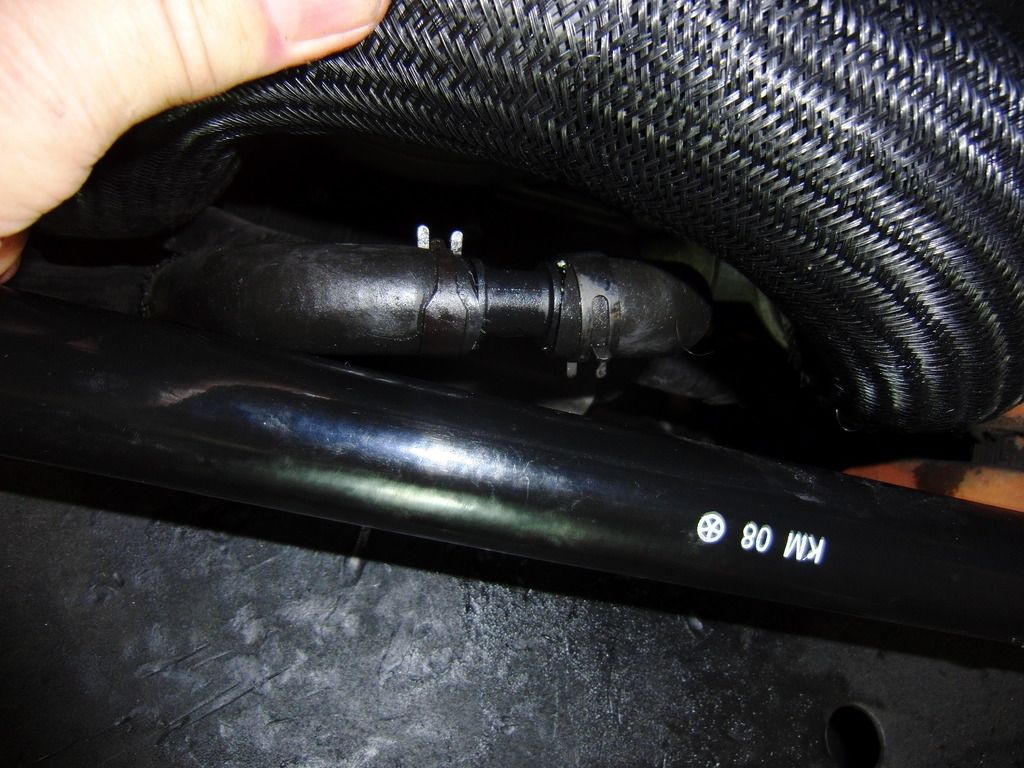

Splice it back together, and reinstall the OEM mounting clamp.
