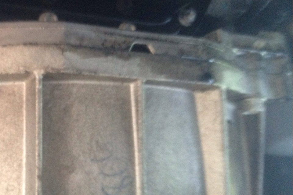

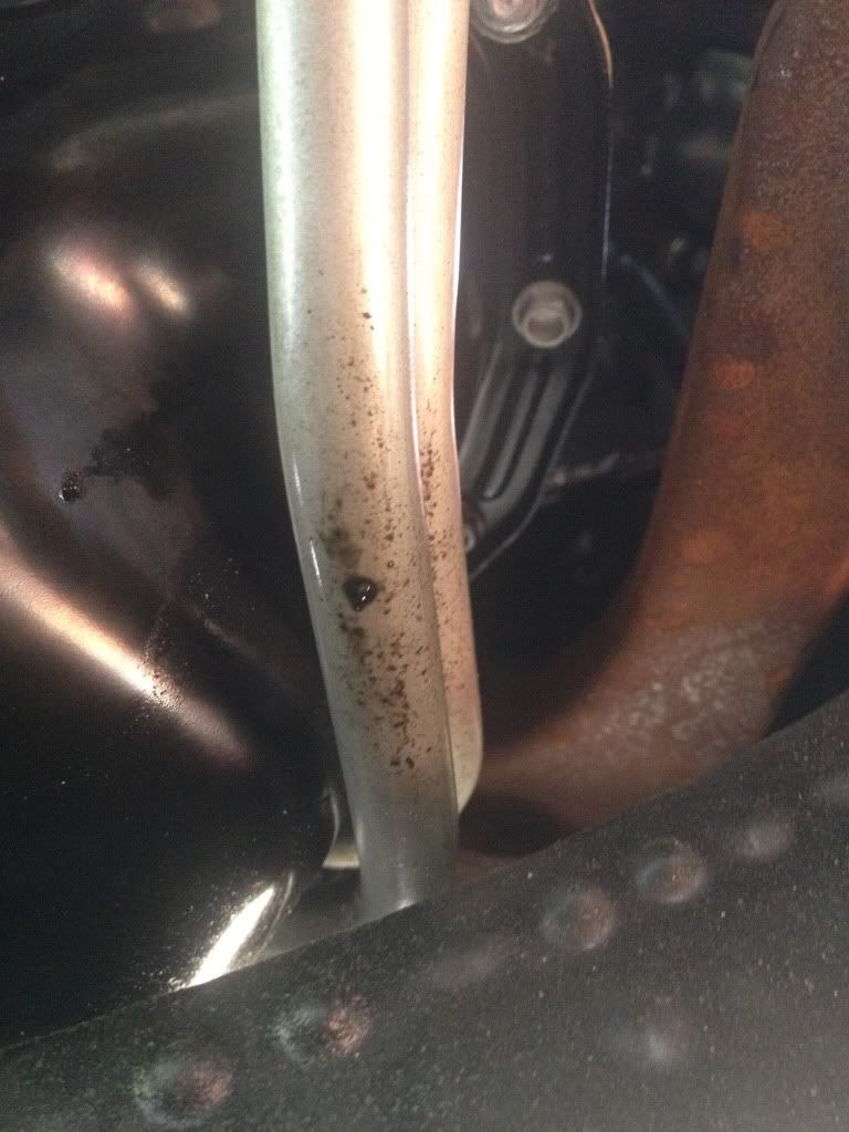

I saw oil in this area a few hundred miles ago and wiped it down thinking it was from the oil change done at 7800 miles. It's dry around the oil filter and drain plug. It looks like oil is collecting on those cooler lines (picture) and the front of the transmission. What do you guys think??

Just to keep this going, I've got a 2013 with 3500 miles on it and I've got oil on the cooler lines and between the engine and trans. I'm going to check all the oil pan bolts but I fear it's going to be the dang galley plugs.

Just a quick update. I checked my oil pan bolts yesterday and the majority of them took 1/4-1/2 turn to get them tight. I sprayed everything off with cleaner and I'll check it periodically.
#73 ·
:thumb I looked at it this AM and the 4 bolts on the end it is leaking from were hand tight, I snugged them up a bit and cleaned all the oil off. I will check later tonight for any oil. I did call the dealer and let them know this but they still want to check the truck out quick on Monday.

Just to toss this out there. My 15 developed an oil leak, with 2700 mi, in the same spots in the previous pic's. Just picked it up after 2 weeks and a day. The valley plugs were the culprit. They changed the main seal, "just because" they were in there. Hopefully this fixes this. Time will tell. Talking with the service writer and he mentioned GM does know about this problem, seems its been a problem for a few years.

While I was under my truck today adjusting my torsion bars to level the front, I noticed a fair amount of oil dripping down those cooler lines. I think its the lower pan, last time it was at the dealer for a front axle leak I looked under the truck while it was on their lift and noticed seepage around the lower pan. The tech re-torqued the bolts and said that should take care of it. Looks like they will have to re-seal it now. I dropped truck off already, I will update with what they do. I hope its not a rear main, or those galley plugs starting to leak - I really don't want them to pull my trans out.
