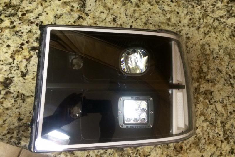

6.) after you have done that you headlight should look like this

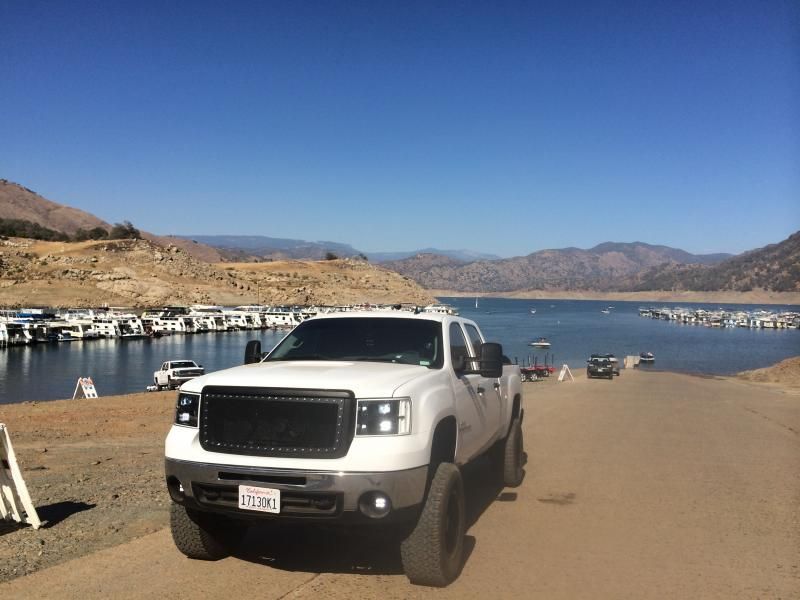

Nice lights. I have the same projectors in my setup except I have a rigid dually for my high beam light output is a huge improvement over stock
