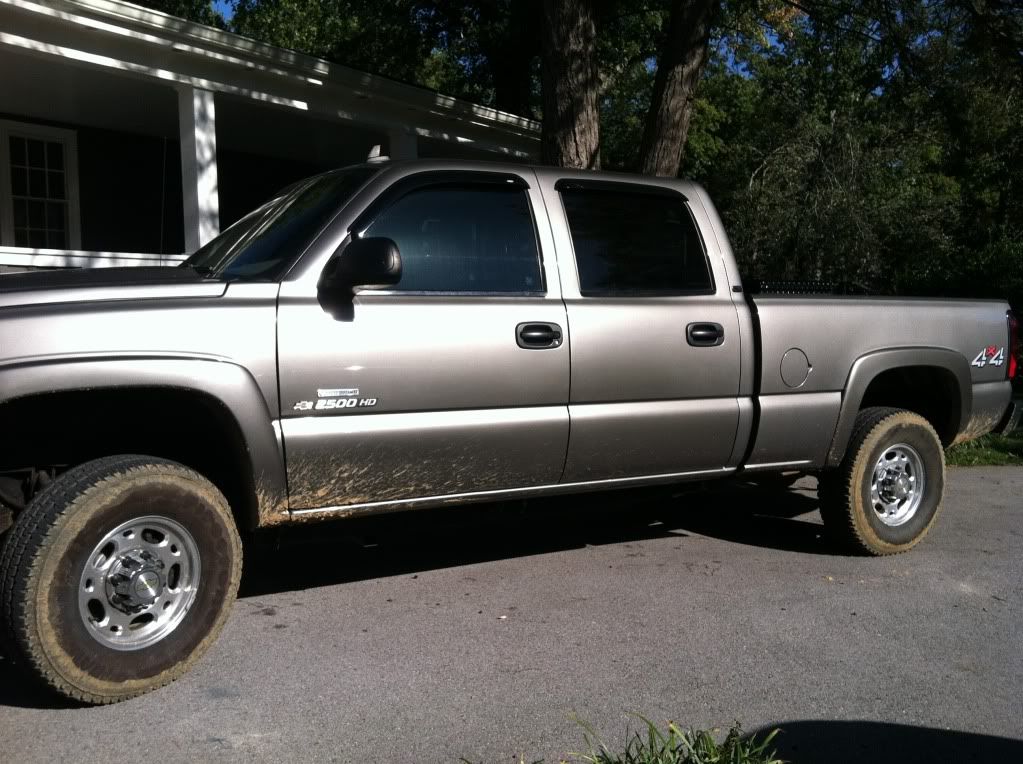

I don't use my truck for offroad fun, racing or sled pulling so i just cranked my torsion bars up 1.5" (green zone) and put 1" blocks out back (you need new u-bolts for that)
I never liked how it steered at stock ride height, just felt heavy and cranking the t-bars made it feel more of how i like it but def sacrifice some ride quality. It still rides better than any of my friends with 3/4 dodge(fiat) or furds.
1,568 Posts
Forgot to give ya a pic, figured it would help ya out.
