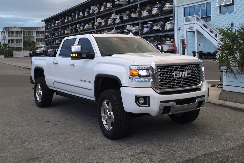

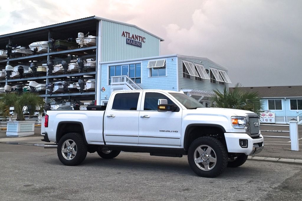

And heres some finished pics of the truck, Pretty much done for now I think. Its amazing how much bigger stock 20s with 35s look than my 22s and 35s on the last truck did.
Thanks bud! Good looking rig!
Discussion starter · #43 ·
Sharp looking set-up.
Like the stance of the 35's on the factory wheels.
Thanks man I appreciate it! I'm loving it too!

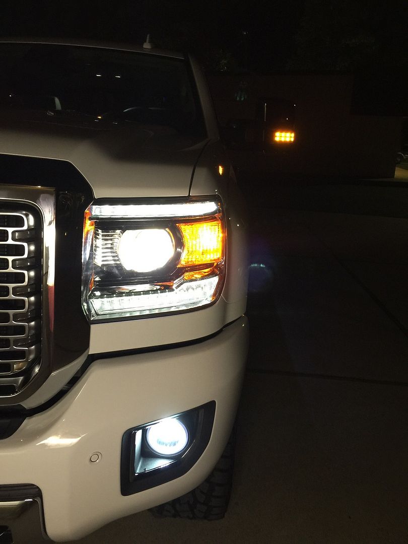

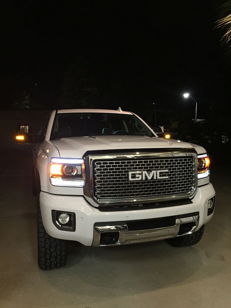

Heres some new pics, nothing really changed just been playing around with lights.
Thank you sir! It's an actual 35x12.50r20 Toyo AT2 Extreme. I'm really happy with them, didn't have to touch the fenders or liners or anything, only rubbed on frame at full lock and was close to the UCA but not touching, but once I threw a 1/4 spacer on the front it fixed it all, and made up for the small loss of track width from the keys being turned up.
