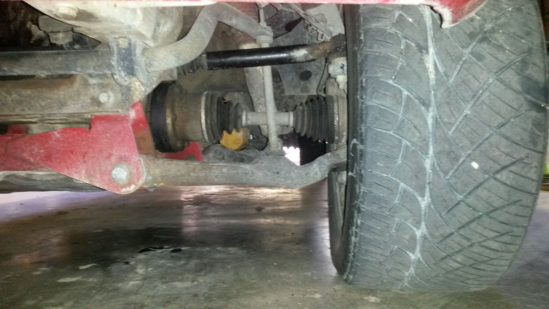

Get some tierod sleeves and lower that front end bud
4,964 Posts
Sleeves are on Still towin in bad.

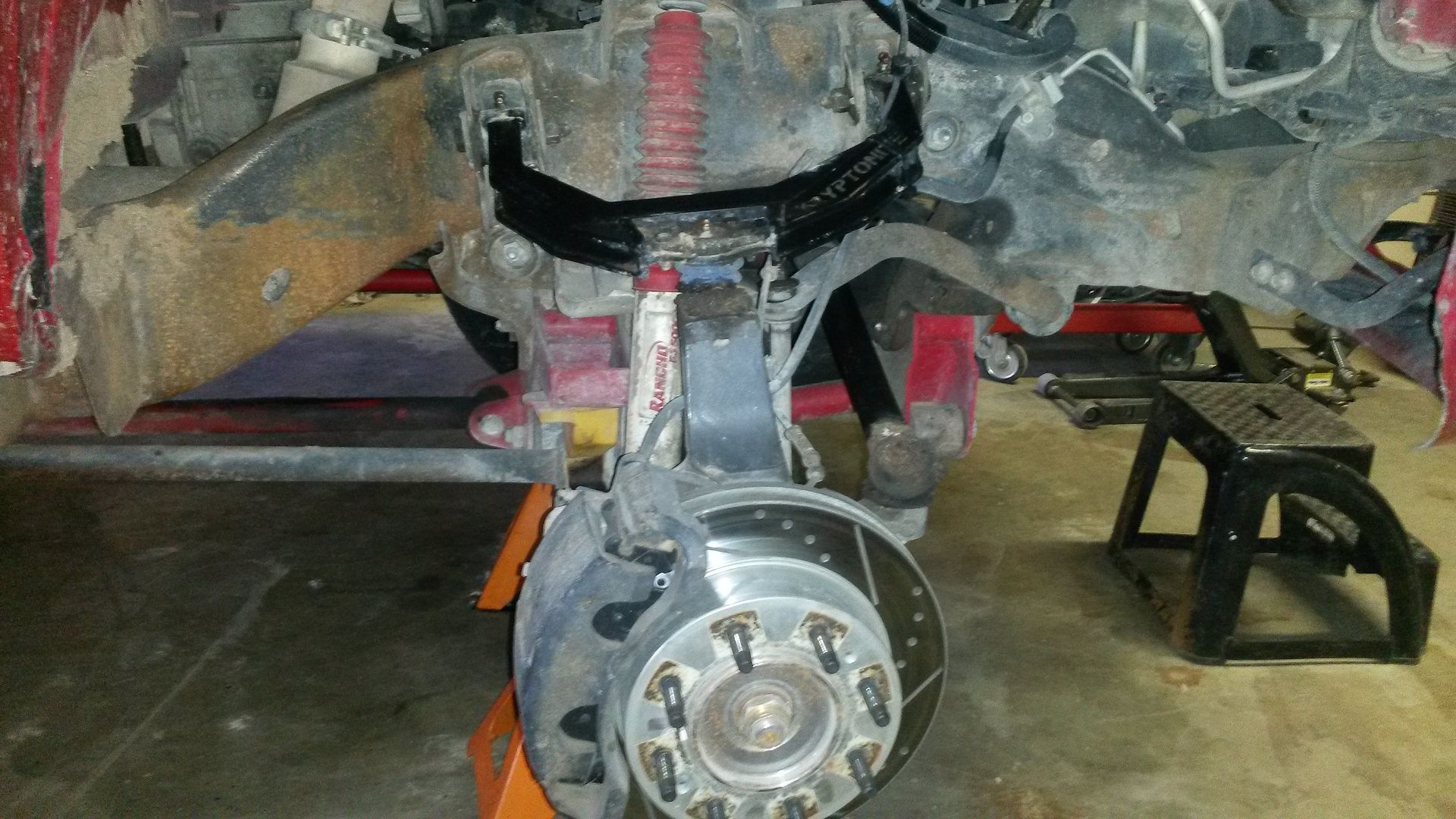

kryptonite tie rods and a center link will help you!!!

Ouch, that looks scary. Brace the pitman and idler arms and lower that frontend bud.
Make it look like this and your problems will go away.

Stock keys are in and front end is slammed

Got a center link brace? I run sleeves and a dhd steering brace with no issues. The dhd center link brace is your cheapest bet but doesn't work with lift kits. Are your stock keys backed all the way out? Post a pic of your angles
