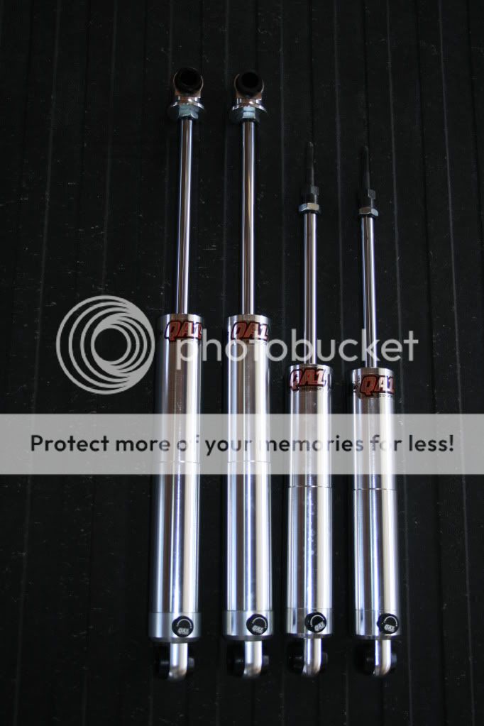

The 999288 has a colapsed length of 12.7" compared to stock @ aprox 10". The Extended length is 15.25" compared to stock @ aprox 14.7". They should be used with shock extensions to be right for your application, that is somewhat inconvenient but I think you will find the flexability the shocks offer are well worth it. The next step up for length and adjustablity are the HAL QA-1 pictured in this image, they are quite a bit more money and extremly nice.
The Bilstein offers more options as far as length but not in adjustability.
