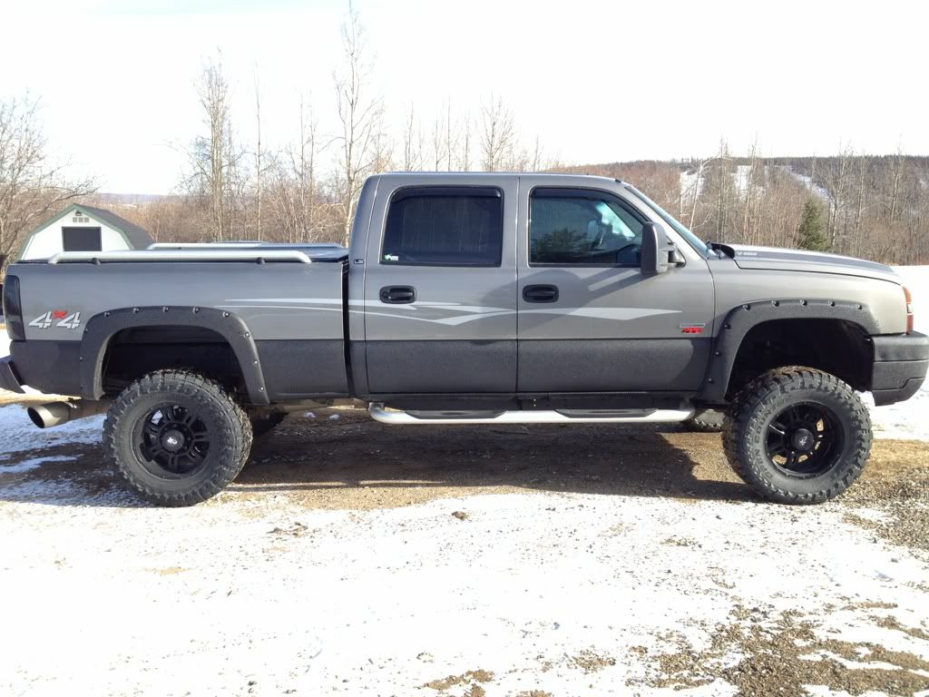

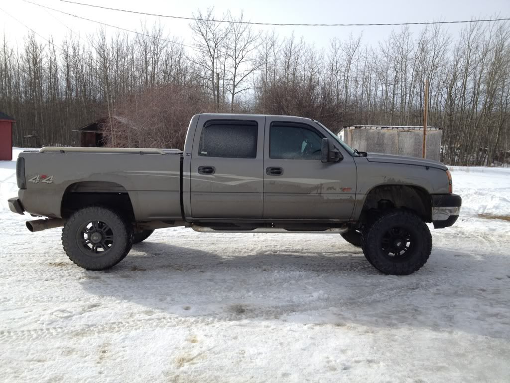

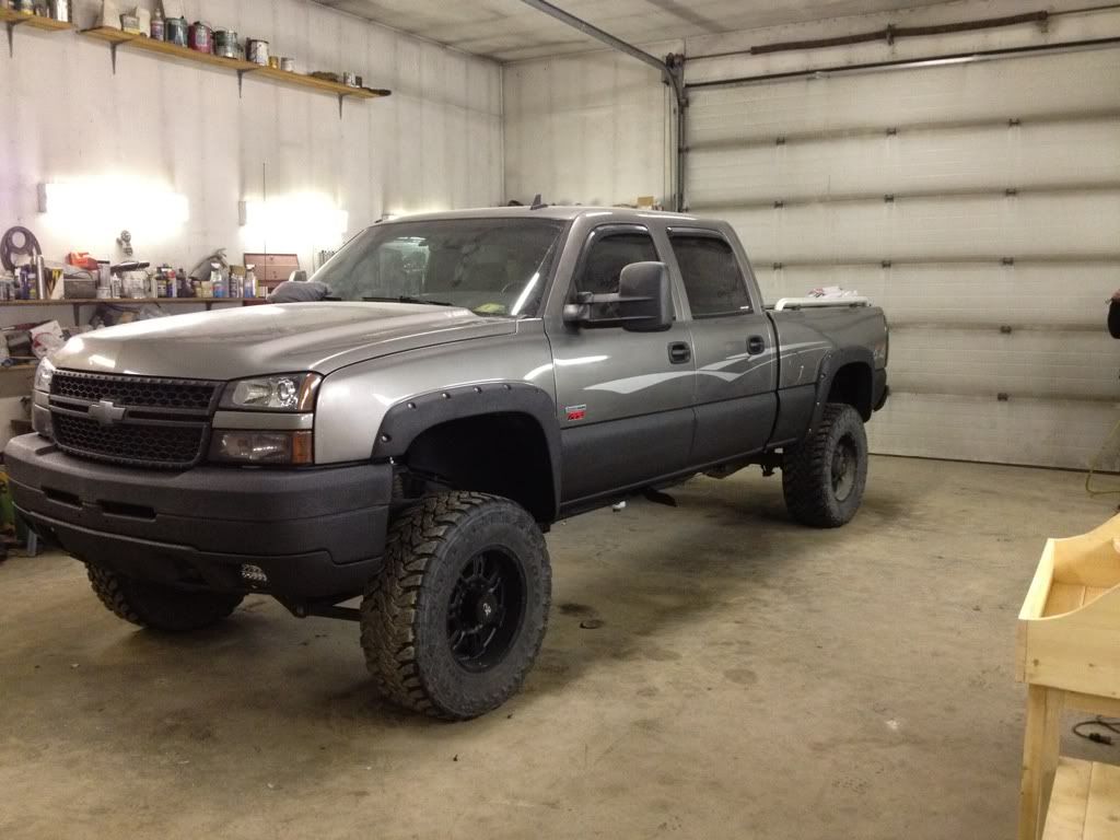

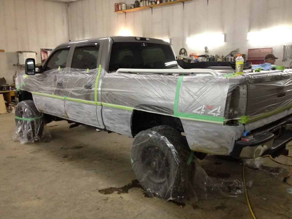

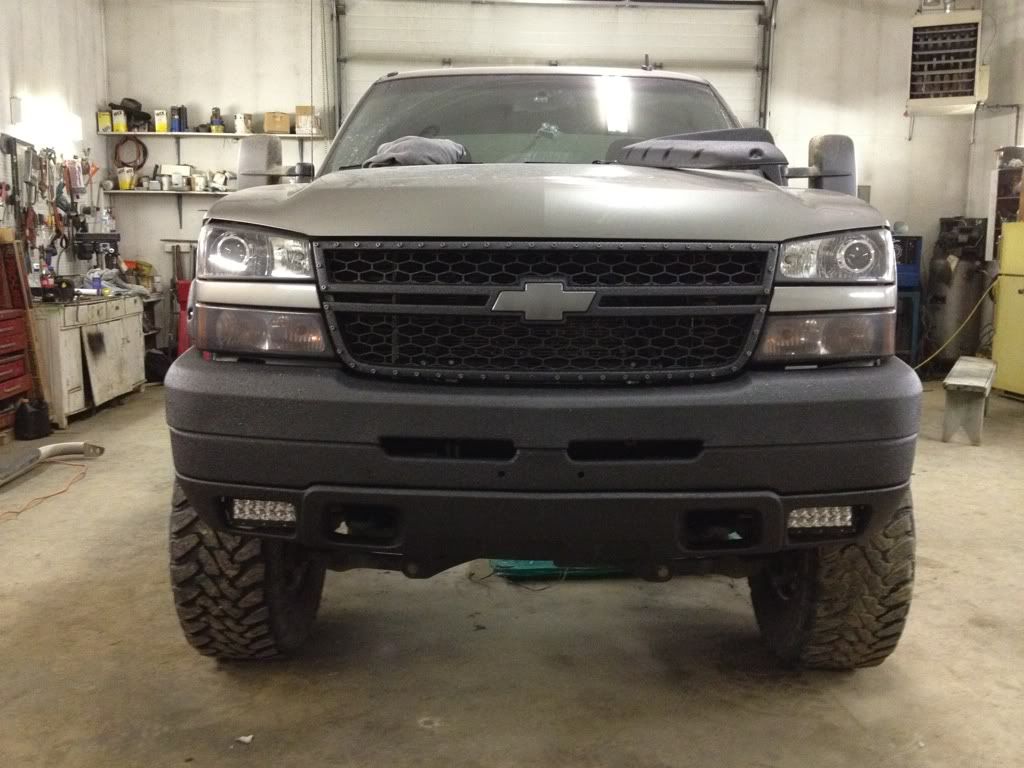

Hey guys after quite some time of wanting to do I decided to pull the trigger and just do it. Thanks Duramike08 for giving me some pointers and the help.
Here a couple of pictures
Before
Prep
Finished product
What psi did u spray? How do u like the bumpers? Truck looks GREAT Man!!! Thanks
Thanks I sprayed it at 45psi and I love the bumpers just took a long time to sand the chrome.
It was 2 and a bit and I wa all 4 bottles to do bumpers and rockers and a little bit of the frame

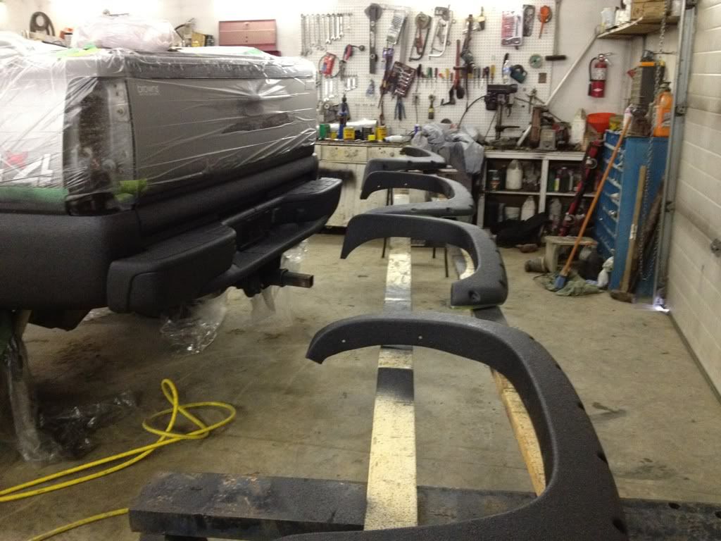

did you spray the area underneath the fender flares?? i ordered 2 kits today. just curious about spraying under the flares and then reinstalling the flares that will be sprayed also.
your truck looks awesome man.

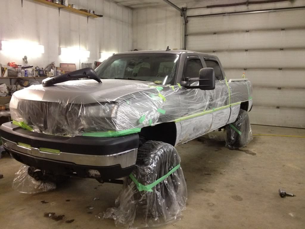

did you use the tape that has a wire in it? I just need to buy tape, sandpaper, body plastic, and paint.

i only sprayed around the fender about a inch so that they fit with a seal. I did not use the tape with wire in it i just used automotive green tape for the main line,then i found this tape and plastic combo. The tape was already connected to the plastic. the overal hight of the plastic was 22 inches, and it worked great. ill get the name of that plasit and tape combo and let you know.i also bought two kits and i only used one.

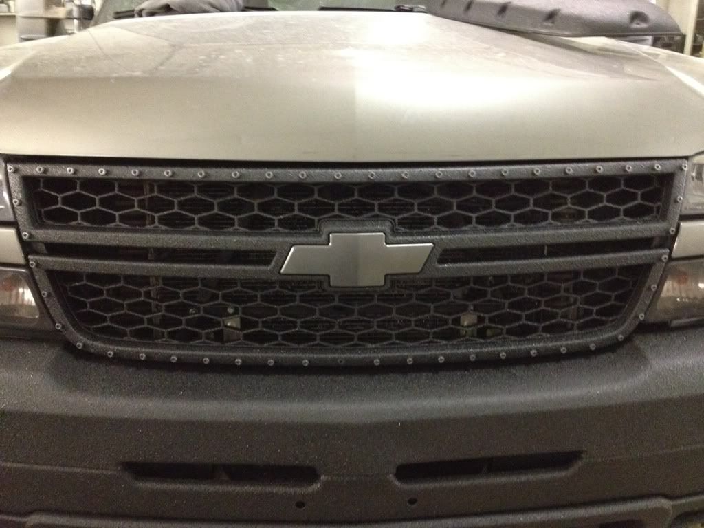

your welcome man and your truck looks awesome btw what kinda grill is that? I like the little rivet things
Thanks its just the stock grille i sprayed it too and i put those bolt in there and just spaced them evenly and color matched then to the truck as well. Better then buying a grille for a couple hundred bucks. i got the idea from some one on the forum.

Hmmmm, trying to figure out if I should just go with black on my white truck or color match the white. This looks pretty good.

thats a good idea I might steal that as well! where did you get those bolts just lowes or somewere? I actually think i might drill holes and use pop rivits maybe ill have to give it some thought

What a mean looking truck. Nice job on everything fella! What did you use for the bolts in the grille. Stainless Allen heads and then paint them with the liner? Looks sick!

You just sprayed the bumpers with the plastic still on? Looks sweet, I need to do mine and my bedrails
