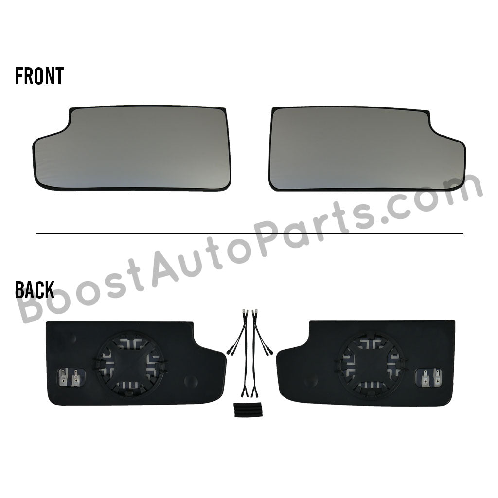

Head to boost auto parts, they have lots of goodies. Including switchback scanning turn signals for the mirrors, and heated glass option for the lower part of the mirror. I already have those two.

Wait i didnt know they have heated blind spot glass!? Dam you viper
