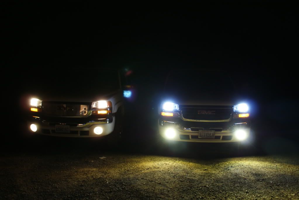

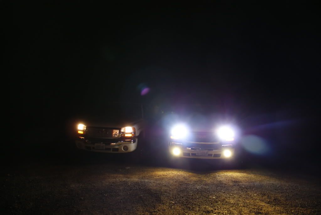

Just thought I'd post some pics we took for a good comparison of stock vs HIDs. Keep in mind that I have the all on mod for the highs, whereas morepower doesn't so he is holding the turn signal stock back to keep the lows and highs on for the pic. I am running 5000k for the lows and highs and 3000k for the fogs. All are 35w except for the 55w highs.
Lows and fogs
Highs (lows and highs vs all on)

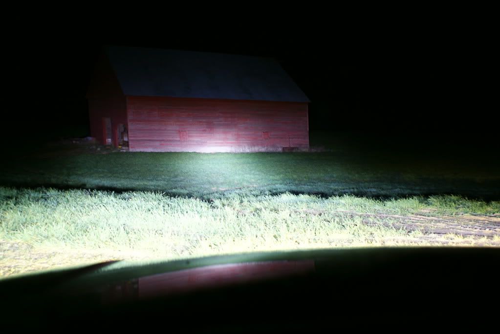

i finally hit a dark stretch of road last night to test where i could reach with my lights
driving i hit a sign a half mile out and could have gotten further on a straighter road
sitting at morepower's (jake's) house me and erik both hit a sign that jake said was at least a mile out

I'm surprised oncoming drivers aren't flashing you with that setup...from where the picture was taken, you can see that the light from the HID's is shooting up waaay higher than the stock bulbs (if the picture was taken at a lower level the stock setup would like brighter I suspect). That's the main reason why HID kits are illegal, because they tend to glare really badly above the factory bulbs and blind oncoming traffic. The best way to do HID's is to do a retrofit that uses a projector setup from a car that originally had it...it's more expensive, but you get a crisp cutoff and the cops will never give you trouble for it. HID Planet has some really nice info on the retrofits...

Actually, steepy and morepower can attest to how low the focal point of my lights are. I agree they look aimed extremely high in those pics, but I believe that that's due to my ISO and shutter speed settings on the cam.
Edit: I am not disagreeing with you on the benefits of projectors, however with the right temperature choice and with the lights properly aimed they are not as distracting as most HIDs out there. I can stare into my lows and fogs without much bother.
Yeah I mean some factory reflectors are worse than others, so that's good that they're not too bad. A lot of people aren't even aware of the issue of the glare at all, but it sounds like you are! I'm also glad to hear that the pictures aren't representative, because it definitely looks high in them. Looks good though, don't want you to think I'm talking down on your truck!
