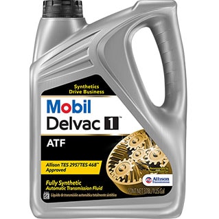

Plain and simple what fluid should I use in an 2002 Allison fluid change.
The more I read the more confused I am.
would this work or should it be TES295
668 is the updated 295 spec fluid. While 668 has some extra goodies....both it and 295 will perform EXCEPTIONALLY well in a pickup truck Allison and will be more than solid in a stock transmission/hp set up. Use either with confidence and they are both compatible with each other.
If it’s stock and never been touched, Dex3 should be used. Even though GM says Dex6 is backwards compatible, some of the seals and sealing rings internally don’t really get along well with the Dex6. That’s last I knew/remember from Allison people anyway. If it’s never been touched or updated with the compatible parts, I would stick with the Dex3 compatible fluid.

668 is okay, Dexron 6 might be an issue. 2 different fluids. The 295 and 668 specifications are from Allison themselves. Dexron specs are from GM. The Schaeffer product Rob is using is a Dexron 3 product for example (a very good one at that).
