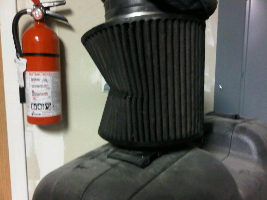

Well, I went to adjust my headlights tonight and found this:
I ended up just puting on my stock intake again. I dont know if the prefilter helped this along, but I think that is what was dirtiest. So, I am now in the market for another aftermarket cone filter. So, any vendors that sell just the filter that will replace the AFE filter please send me a quote. I had a proguard 7 filter, but I dont really want to run it anymore just in case. I want to move to a dry filter...not oiled.
Here's another picture of it:

yeah i was surprized when i saw it. I know it was dirty, but i didnt think it was that dirty.

Wow! What do you think caused the air filter to crush that bad?

yeah i would, but I dont trust it to filter and not get further damaged now. It is caved all in. I think if I straightened it out, there would be holes in the filter, which would defeat the purpose. I want to go to a dry filter anyway....been holding off...well, this gives me incentive ;)
I think it was a little area crushed from removing and installing...I think the prefilter did it...although, I have only about 4 or 5,000 miles on my truck (maybe less) since I cleaned the prefilter. I have noticed my truck throwing a little more smoke when I get on it....I guess that is why. I was able to get on it pretty good yesterday. I'm thinking about getting the amsoil replacement, S&B filter, or the AFE dry...probably going with something other than AFE though :rolleyes:

I would say it was the pre filter too. On my atv I have a K&N and the prefilter had gotten so dirty that the engine would not achieve full throttle and just bog down. Gotta keep an eye on the damn things.

I went back to stock as well. I had an AFE, it was starting to colapse as well. The stock unit seems to work as well if not better. A while back someone posted some test results for stock and aftermarket. I wish I would have known about that report before I spent the big money on the AFE.
