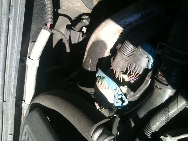

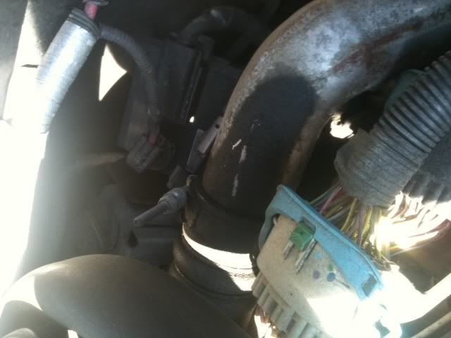

I just noticed this the other day and am not sure what it is. i am hoping its not caused because my egr still isnt blocked and it has built up so bad thats its blowing out the pipe. so any ideas would be great along with course of action, thanks

Thats oil from the pcv. That is why we re-route it.

wow, they actually did work! anyway, so i need to reroute my pcv? is there going to be any problems from this or can i just reroute it and it will clear up?

It will not clear up but it will not get any worse. Unless you clean it all up. It will not cause harm the way it is.

If you reroute the PCV system, your engine will stay a lot cleaner, because the oil will not settle in the Intercooler. The oil leaks around the hoses under high pressure.

ok now i know whats the next project on my list, thanks guys! is there an easy way to clean all this oil up while im rerouting it

I did the reroute, and cleaned up the mess from before it was rerouted. Took the boots off any simple greened them. And the hot side pipe.
