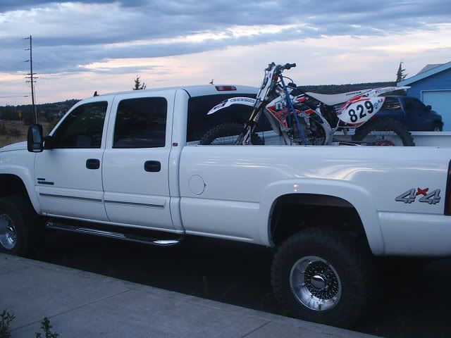

I bought a brand new 2007 Chevy Sil 2500HD dirtymax. Couple of questions I have. What truck do I have? I hear all this talk about LBZ LLY ???? I love this truck. I bought it in Feb of this year. I already have 14000 miles on it LOL. Today it said the fuel filter needs to be changed? I'm thinking there must be a reset like there was for the oil. What things should I look for? I want this thing to last. Heres a pic. 6" lift and 35" open countrys.

The filter is on the passenger's side of the engine compartment. It is pretty easy to change. Do you have the owner's manual for the truck? It has detailed instruction on how to change the filter. As far as the engine RPO code goes, you probably have a LBZ. Look at the 8th digit of the VIN and see if you have a D there. BTW, welcome to the site and nice truck! If you need the duramax manual, check this thread out: http://www.duramaxforum.com/forum/announcement.php?f=82

Nice looking truck !!

The LBZ is the 06 model year engine carried over to 07 until January (also called the "classic").
The LMM is the 07 model year engine (with a diesel particulate filter).
The LBZ is 360 hp, the LMM is 365 hp -- both have the same peak torque.

great lookin truck n welcome to the forum.. btw where do u live
