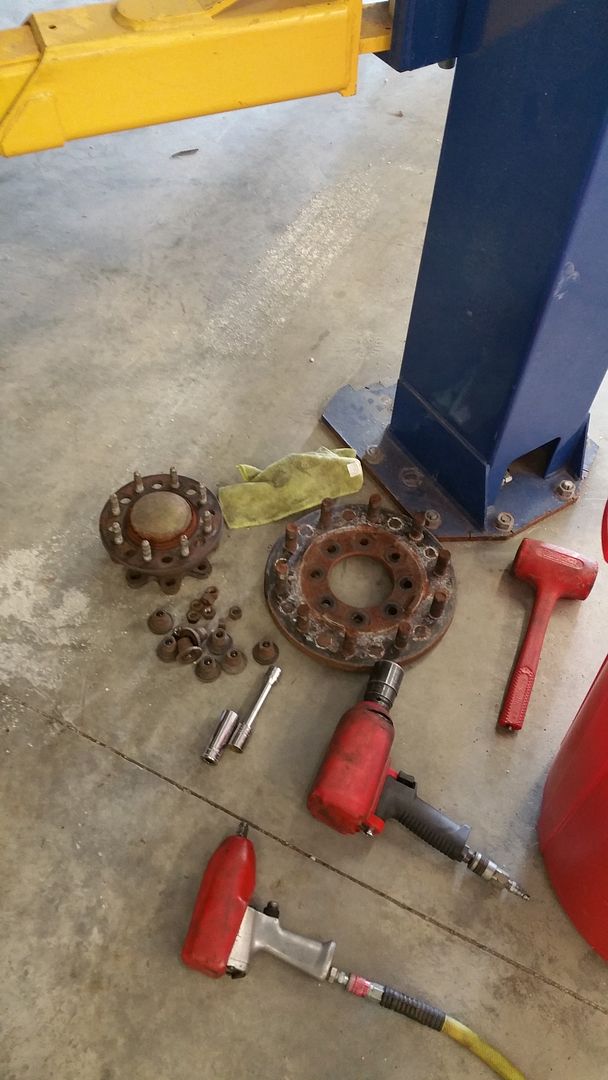

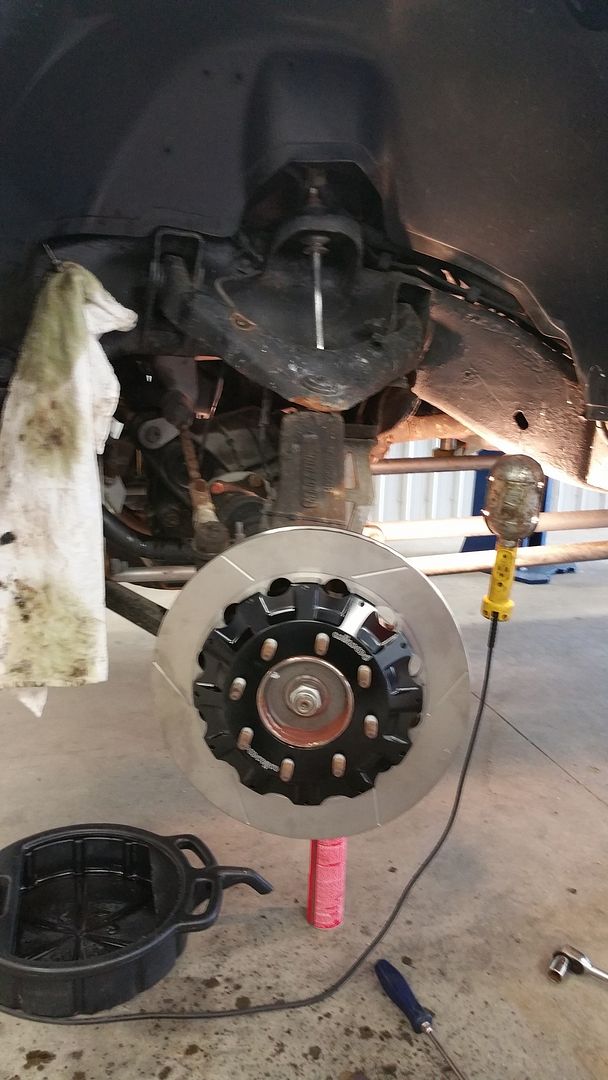

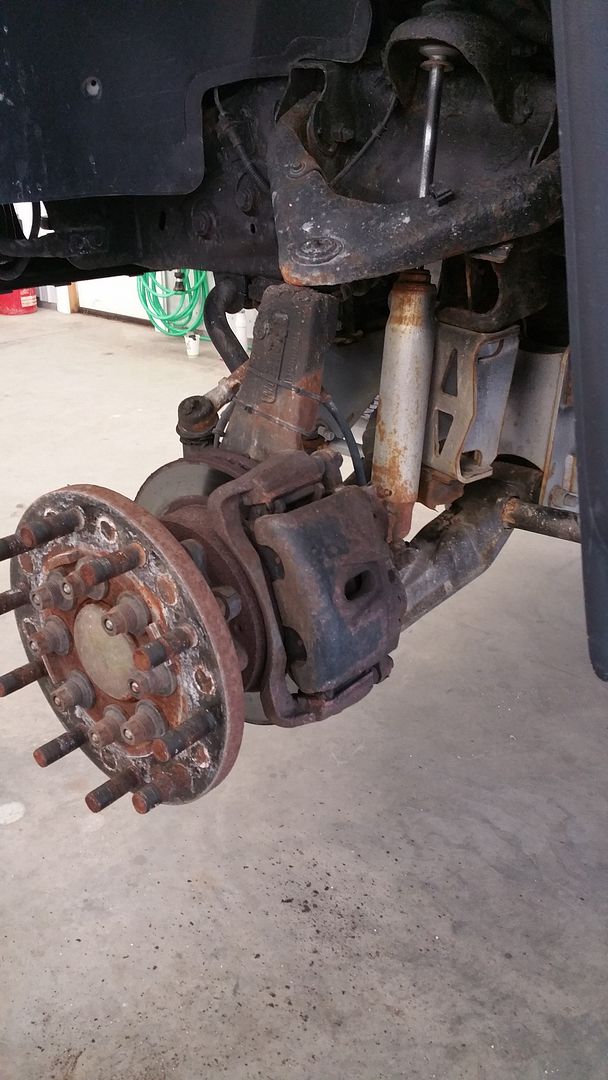

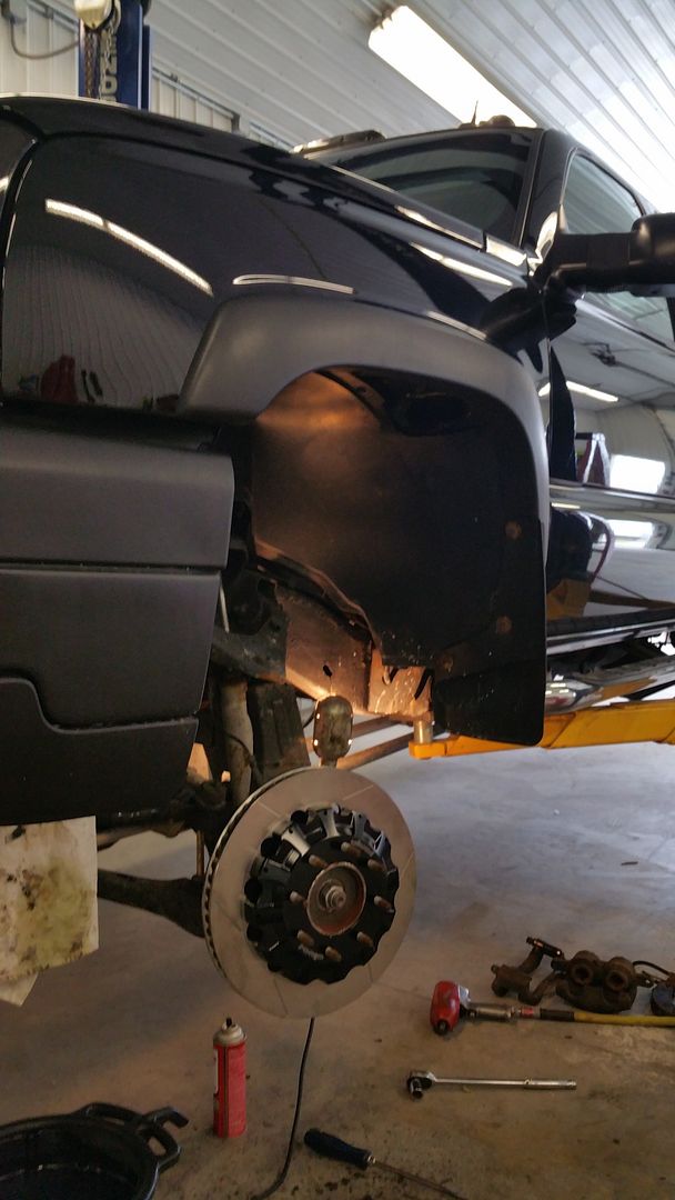

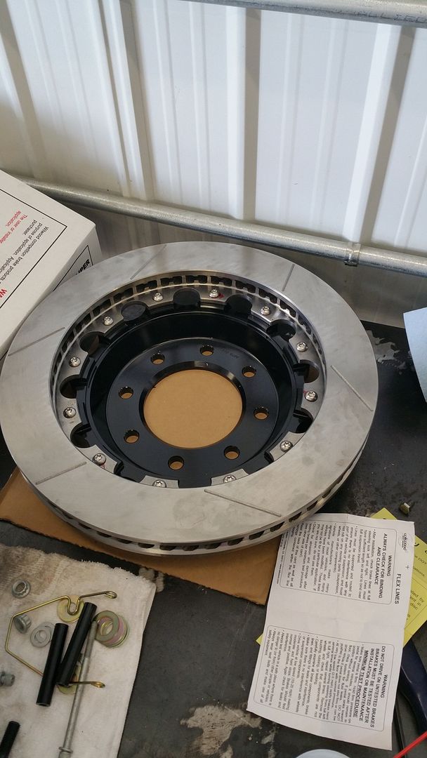

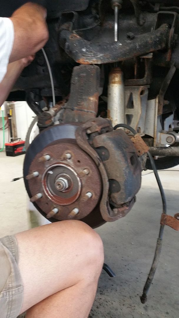

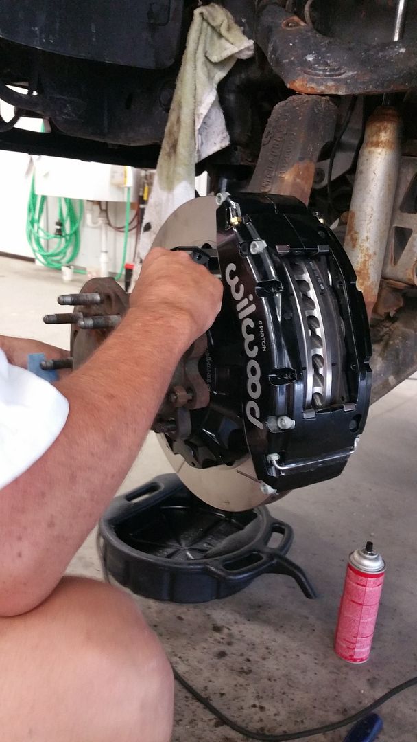

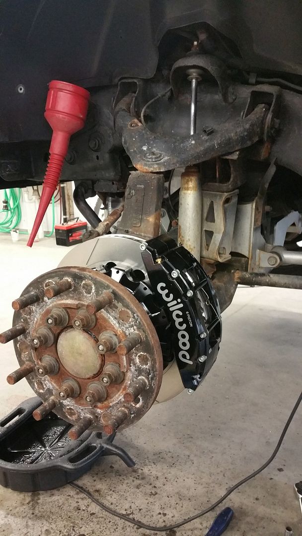

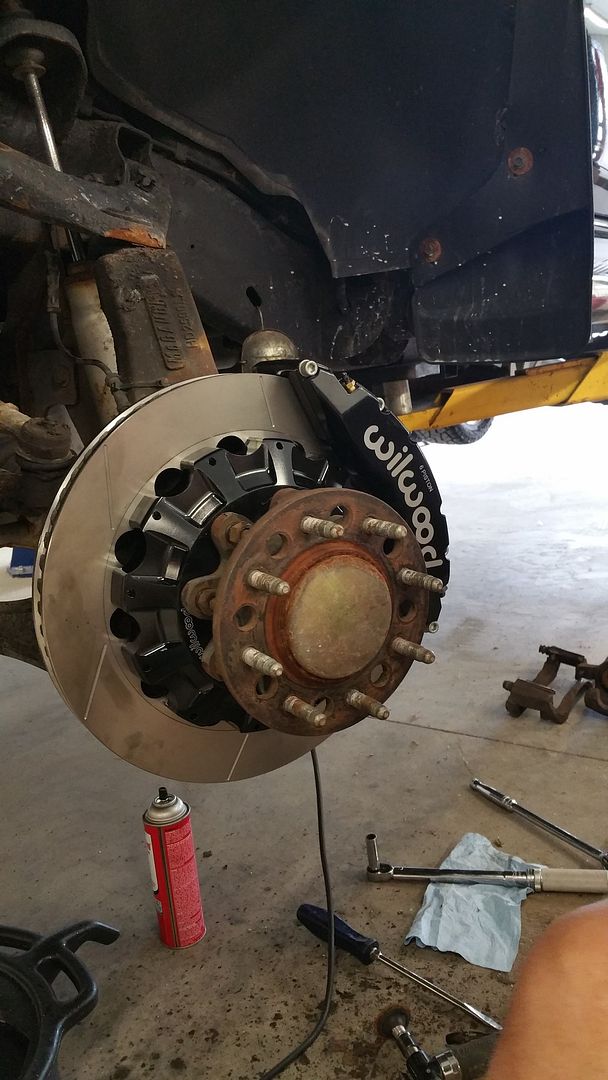

Finally saved up and got myself the Wilwood big brake kit, taking the truck down to George soon to build the tranny and do 40 overs I figured I'd need to have more stopping power..plus the 22 tractor wheels are already heavy enough as is.. anyway here are some pics throughout the install..really easy installation, but they sent me the wrong flex line kit so I won't be able to test them till tomorrow (they were more than happy overnighting me the correct ones).
Stock brakes w/ 10 lug adapters^
16" slotted rotors^
And now we wait till the new flex lines come in^

Flex lines came in, pics of final install with plenty of clearance

Looks great what is the min wheel diameter with those?
I would have been under that truck all day trying to clean up all that rust! :poke[1]:
53 Posts
Thanks! Requires at least 20" wheels...I know i live in VT its a constant battle..every couple months I spend a few hours with a wire brush and some paint under there..
