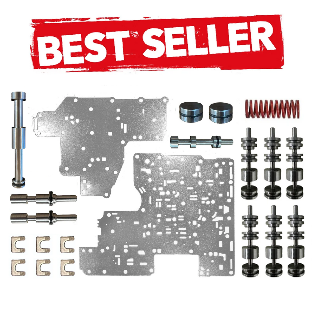

Just put the sonnax Low Limit feed valve kit in your existing valvebody and be DONE with it. Its like $35 and was actually engineered and patented. No stupid orings. The orings on the next gen kit scare me more than the OEM VB failing. If orings were the solution then GM would have done it eons ago on all VBs as they are pennies each.
Majority of problems are from the feed limit low valve wearing and causing cross leakage. Yes, the VB themselves can crack which is why you dont want a 'shift kit' as they are already on the edge of cracking between work tracks. I fixed mine on a sunday morning. Easy and cheap. Works great.
