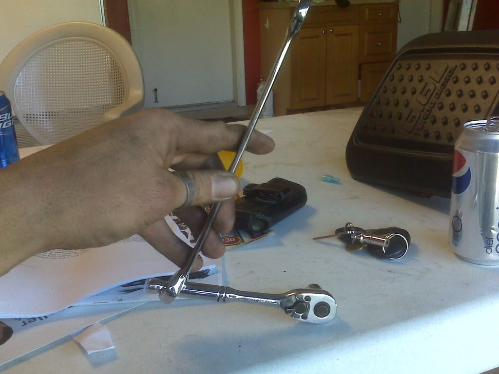

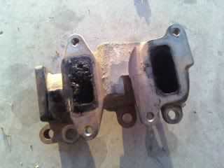

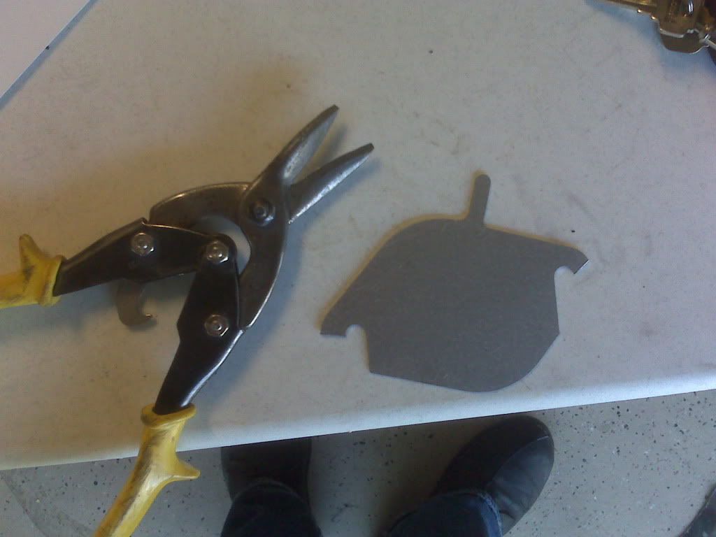

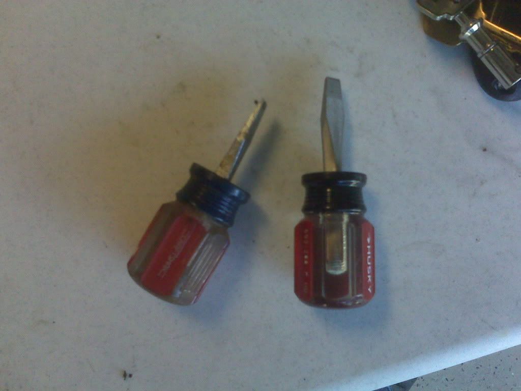

Ok did it and it is really a pain in the neck but it's worth the pain and the blood. Instructions were very good and it's a doable mod but be really "persistent" it took me 1 hour to only get the egr bolt loose. Good luck guys and I posted all images.

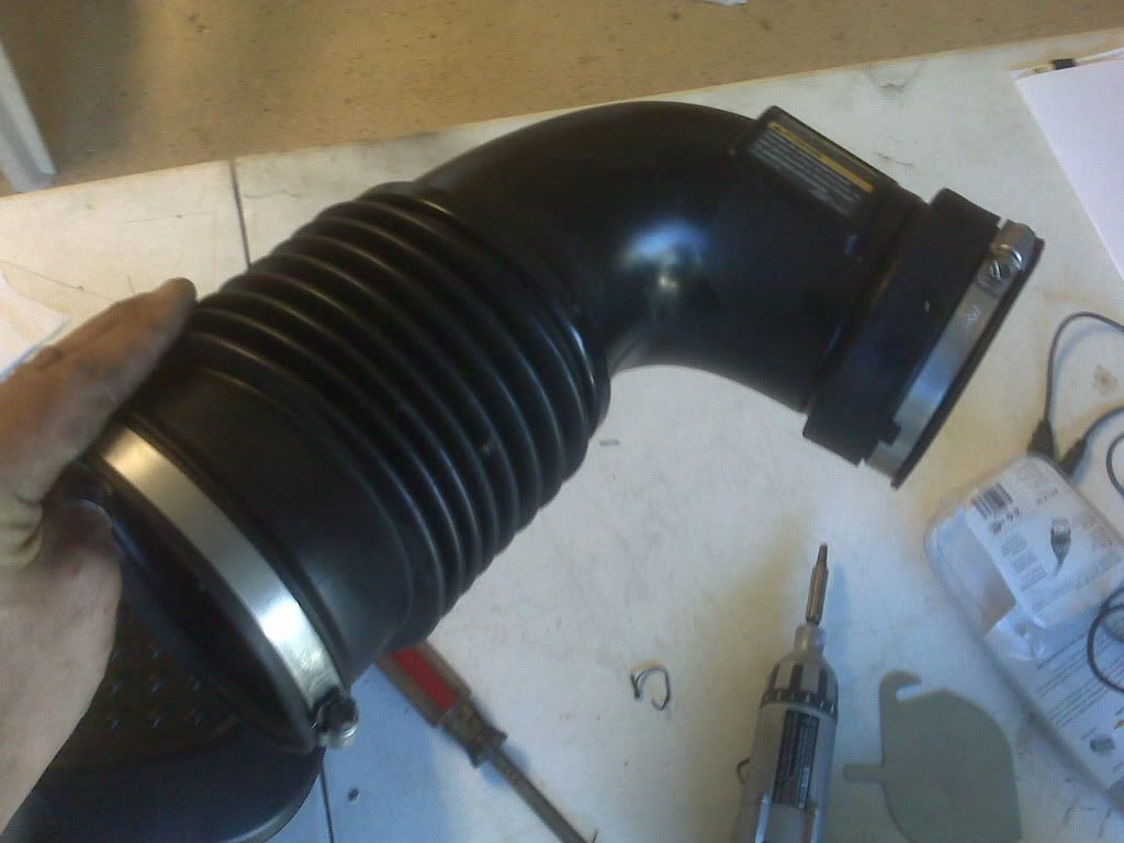

Cut off plate "ears"

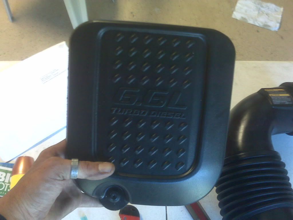

Remove elbow and resonator cover.

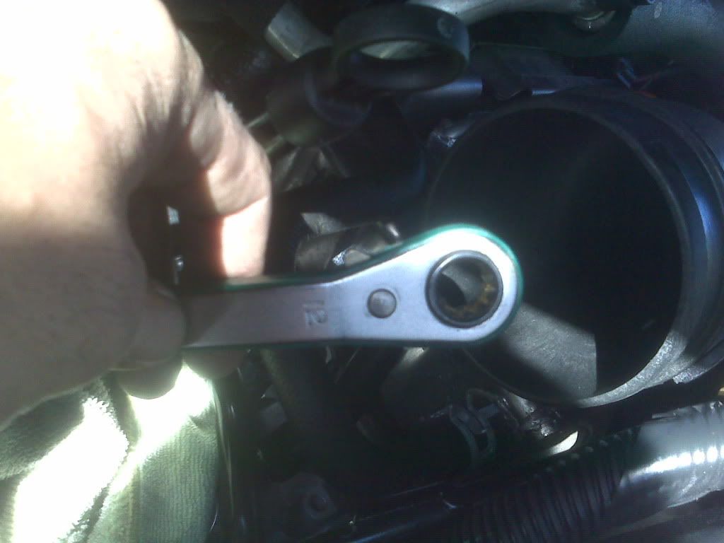

Remove sensor with 14mm wrench

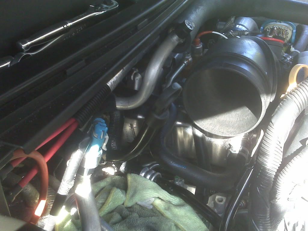

egr where you need to put the plate. Screws are behind that piece
take wrenche and ratchet. 12 mm
you will need to get some leverage. I used another whrech becaust it is really hard to do.
Remove the screws and wedge the 2 small screw drivers between the pieces

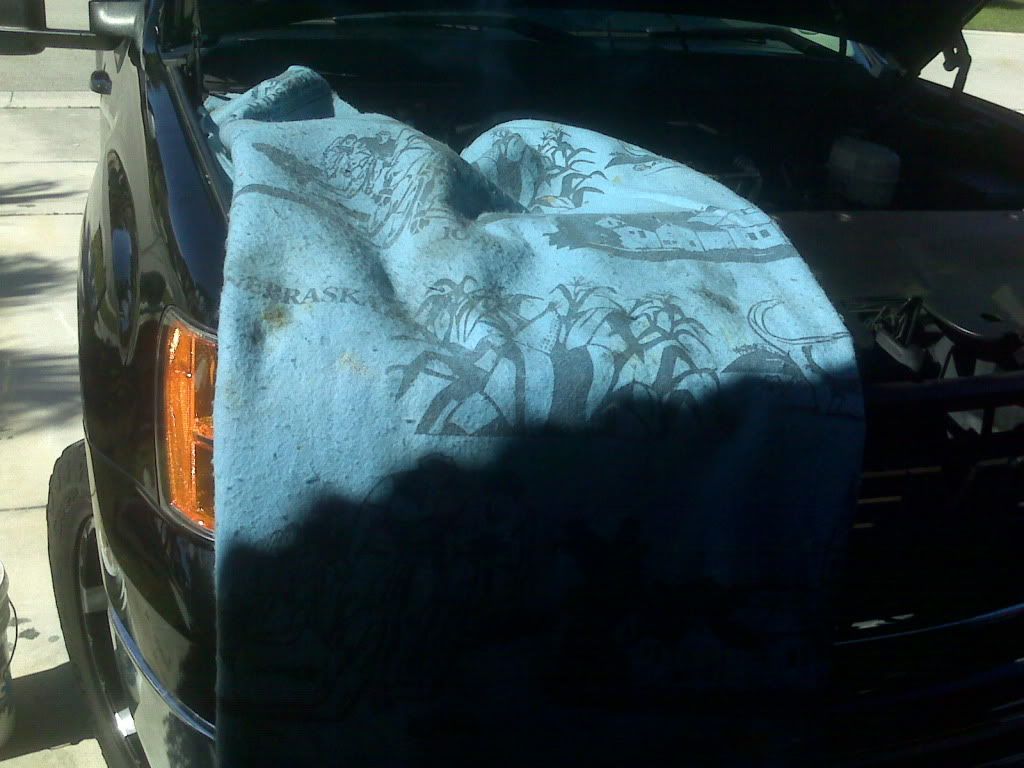

The Blanket on the motor.
