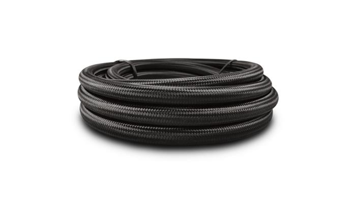

This is the hose I used.
Vibrant Performance Braided Flexible Race Hoses 11973
