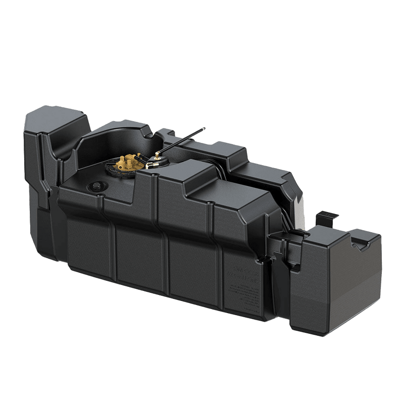

Any more thoughts on this tank? Still going back and forth on it as I haven't heard yet if the DTE will reset or not and if it does, how long or many tanks that takes before it stops freaking out after the fill up.
Also, I've heard the filler neck is a little smaller than factory nd this causes a leak with filling the tank. True or no?
I contacted IdahoRob from ATP and asked if EFILive would/could reset the DTE. He said that the only thing that EFIlive was able to adjust was the fuel gauge to read correctly. The S&B doesn't have that issue since is comes with an OEM style sending unit. The Titan & TransferFlow tanks reuse the stock sending unit which isn't calibrated for aftermarket tanks so EFILive would adjust the "gallons at full" to re-calibrate the fuel gauge...
My fuel gauge is 100% correct with the S&B tank...
Discussion starter · #76 · (Edited)
Admittedly, I only have about 7300 miles on my 2021 3500.
This tank was installed when very early on after I received my truck. 100%, I would do it again. I have yet to go a full tank without towing something, but my last tank had the least amount of towing and I think I had over 900 miles on the tank, mixed driving, with a Derringer and Pedal Monster.
My DTE seems to be getting better and better, though not as accurate as it was in stock form. But it does seem to be getting there and I do think it will get there eventually.
The filler neck is the same size as OEM - it actually reuses the OEM filler tube. Your post is the first I've heard leaks.
I'm pretty sure my truck is still learning and adjusting. After about 120 miles, the OEM fuel gauge drops to zero - but as soon as you shut the truck off, the next time you start all is well and it never happens again until the next fill. Titan Tanks says this will eventually stop but I don't think I've filled enough times for that to happen. The digital cluster takes more fill ups. For me this is a non-issue and aside from this my OEM fuel gauge is just as accurate as when the OEM tank was installed.
I also have the fuel gauge percentage showing on one of my iDash gauges. Even when the OEM gauge drops to zero the iDash reading remains available and still shows its correct percentage reading. I fill up when I get to about 8-10% remaining most cases.
For the newer tanks the OEM sending unit transfers over, but you do replace the float arm with a longer one that comes with the tank.
My biggest gripe isn't with the tank - it's that no fill station will allow a full fill up without having to swipe my card twice (unless paying inside maybe). Most places have a cut off of $100 though some are a bit higher. My last fill was exactly $200 but it had been about 70 days between fill ups. Had to pay twice, and with rising diesel costs, this isn't likely to change any time soon.
Overall, I'm satisfied with the tank and even if I didn't have a 5th wheel to tow (where the extra capacity really shines), I would do it again.
I agree. My indication on fuel level is spot on with the new tank. S&B shows on their site to be able to correct the mileage to empty from the DIC. When I called them about this the application was only available on the Fords and maybe Dodges, they did not have anything that worked for GM. Actually all I use from the DIC is the gallons used. One of the gas stations I use to fill up give a 5 cent per gallon discount if you prepay inside (I think it is a gimmick to get you to buy something inside when you fill up) but when you are filling a 62 gallon tank, it adds up.
As for leaking at the filler neck connection that is news to me. Mine was fine. The only thing I get for a leak is the little breather line did not get routed up and away from the tank when I installed mine. I might get a drop or two overnight when it is topped off but nothing from the filler neck. My only regret on this tank was not doing it sooner! There is easily a 40 cents per gallon difference in my area on what I pay locally for diesel and what they gouge you for diesel at the big truck stops on the interstate. This allows me more flexibility on where I stop for fuel when on a trip. That adds up quickly! The only other mod I have done since adding the S&B tank is I put a heater circuit on my lift pump. With that big of a tank it definitely takes longer to get the fuel up to temp on the really cold days. Dean
