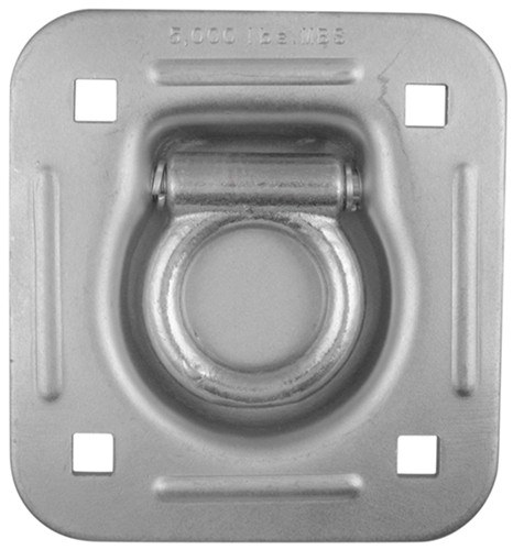

The flush-mount HD anchor points are rated at 5000# break strength, 1600# working load limit. These come on pretty much every trailer sold.
Trailer D-Ring Tie Down, Recessed 5K Brophy Trailer Cargo Control RR05

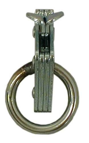

The heavy duty rings are 6000# capacity, 2000# working load limit, more than the flush anchors.
E-Track D-Ring, 6K Round Ring Erickson Trailer Cargo Control 59147
