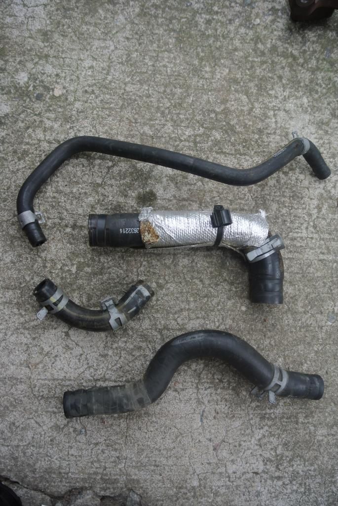

Step 20: With all of the hoses and sensors unplugged you can now take out the egr cooler. It may be easier to remove in 2 sections. (7 bolts hold the cooler in place). keep bolts and gaskets.

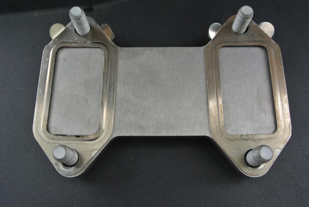

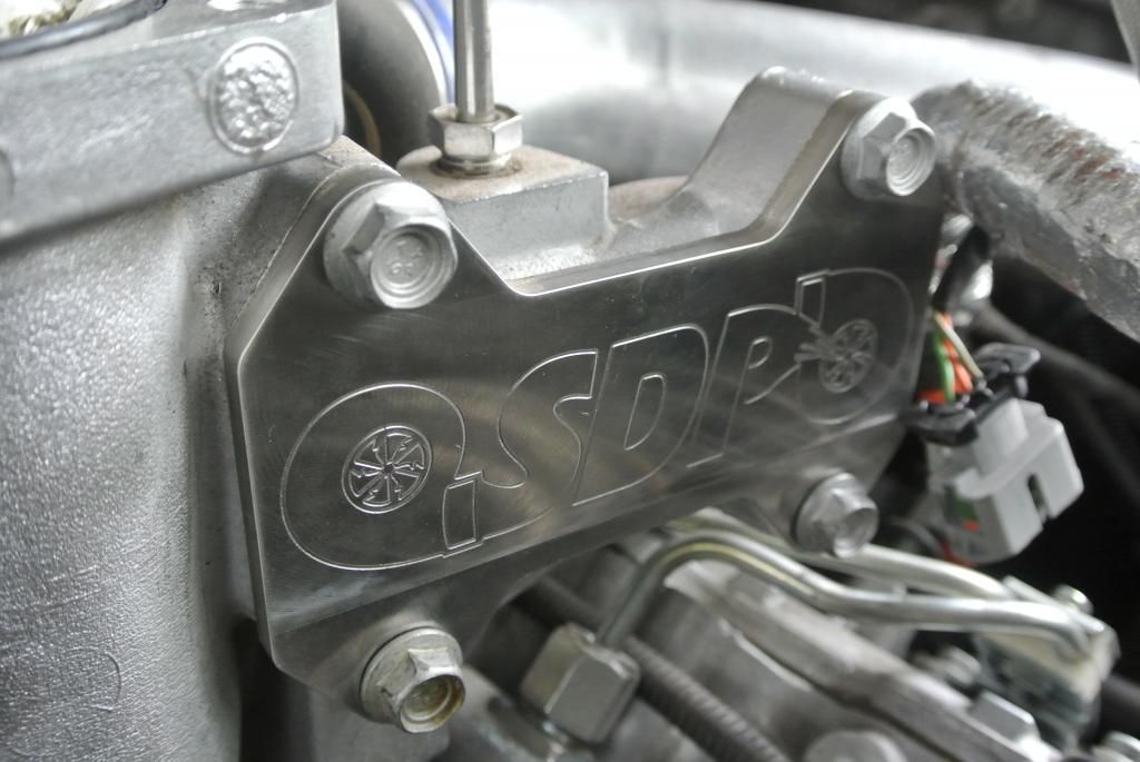

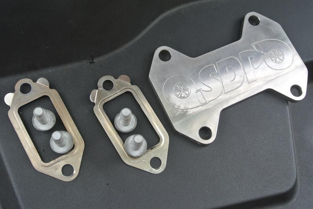

Step 21: Now you are finally ready to install the delete kit!
Start by installing the blocker plate using existing gaskets and hardware.

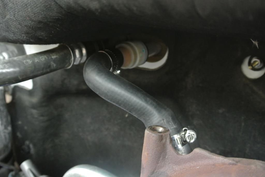

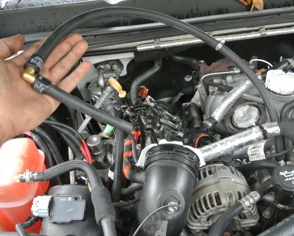

Step 22: Trim the "L" shaped hose to desired length. As you'll notice, there is one end that is lightly larger. This end will go on the metal tube connection. Tighten with hose clamps.
Step 23: Install the longer coolant hose. Tighten with hose clamps.
